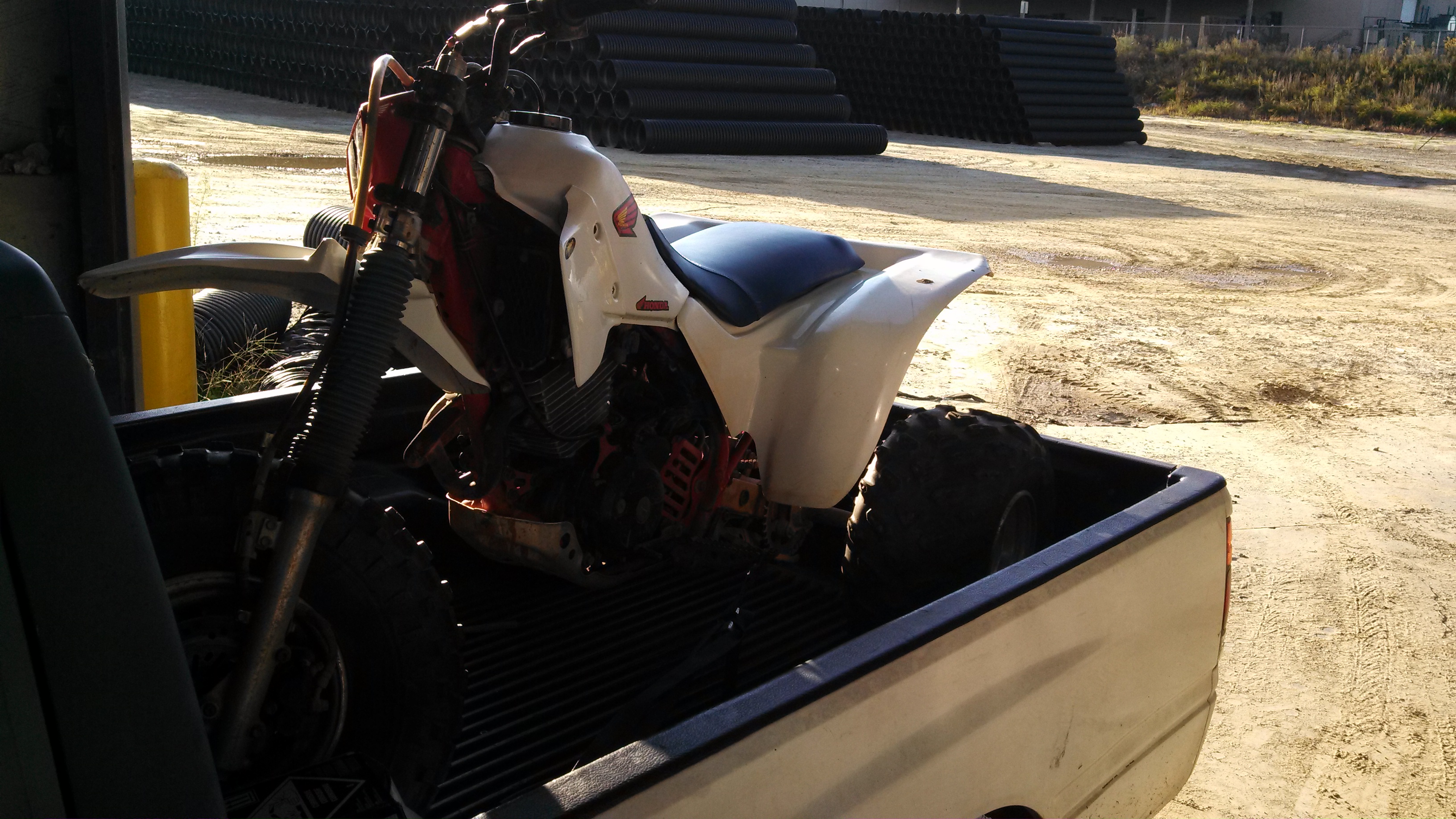

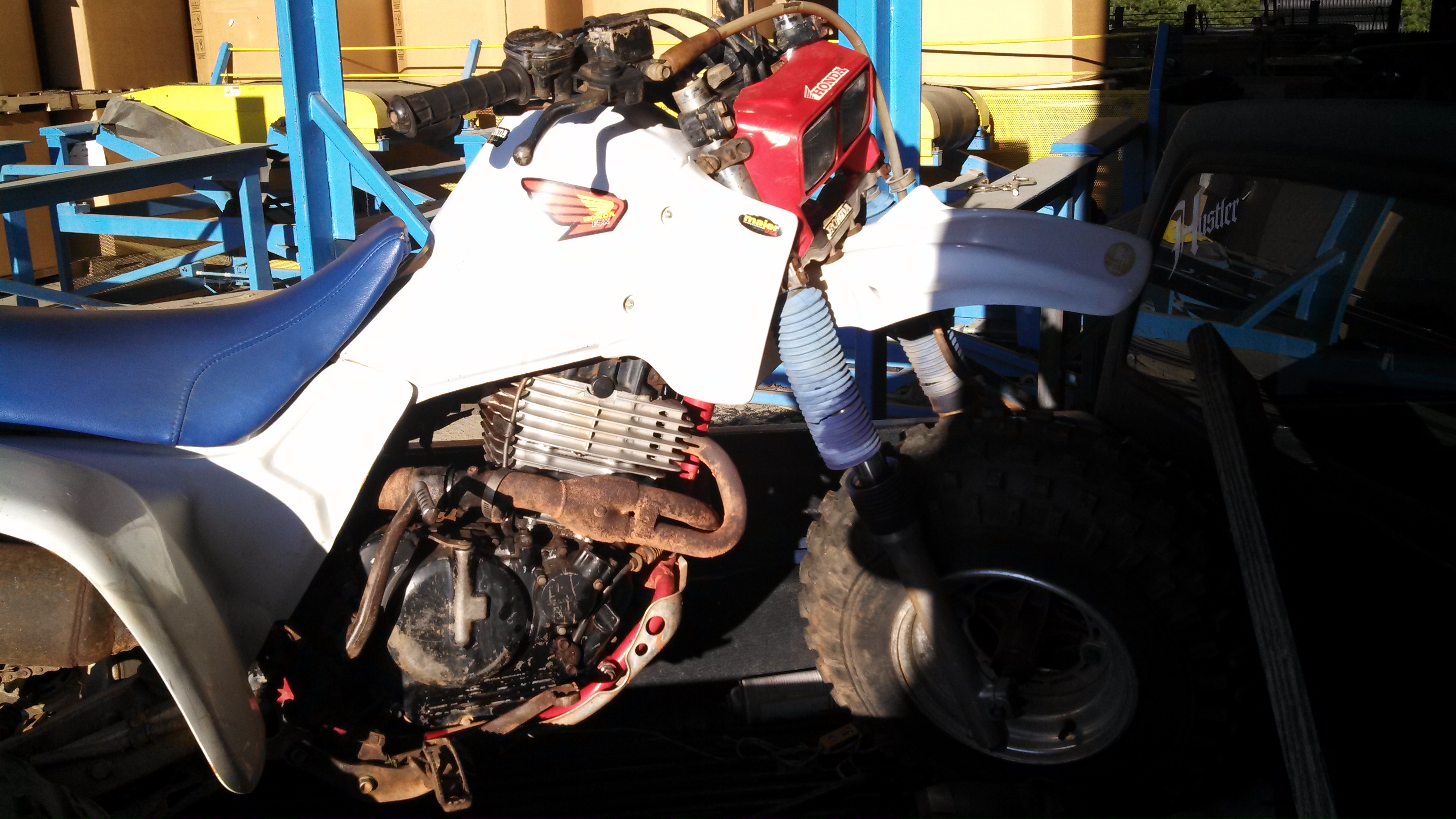

    All her glory.won't be this color long.got an extra tank in the trade.goin black and white with a metal mulisha theme
