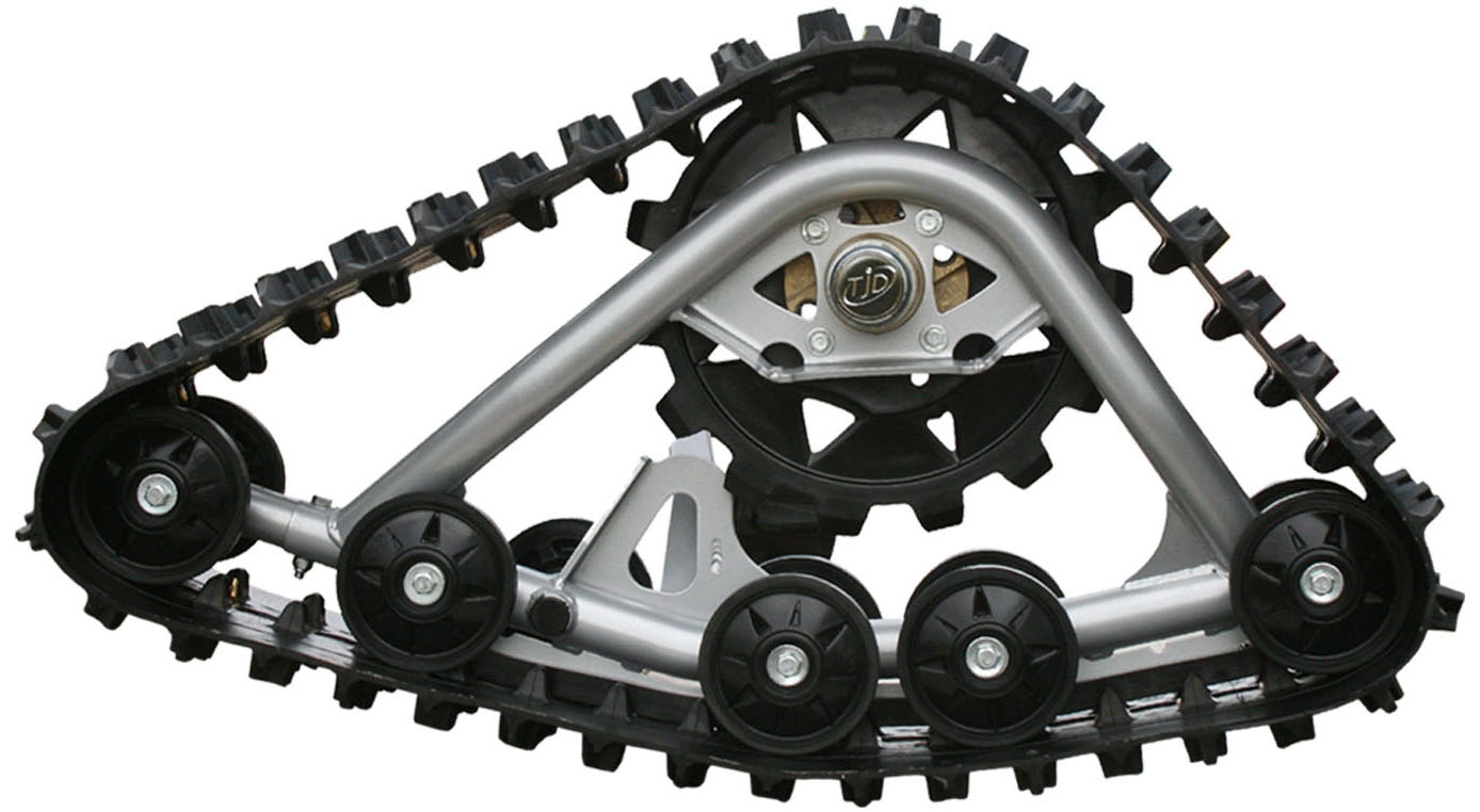

    Crazy prices..I've got a project in the planning stages for a snow-trike.
    The thought is to install a pair of ATV tracks on the rear drive of one of my trikes. I've seen used sets go for $2000 on CL/Kijiji..that is enough tracks to do two trikes!!
    My buddy Scooter is working on fabricating front ski assy.
    May not complete for this year, but I'd like to have a working snow-trike for next year.

    I would like to if I had some extra money but I think I'm going to go to the sled junkyard this weekend and buy a ski that has a center pivot point, (not one of the older styles with the leaf spring,) and buy some square stock and pipe for the axle to slide in to. Drill the square stock to fit the pipe and weld it in and cut it to the inside diameter of the axle and then just some sort of clamping system up higher like scooters. I will have to figure something out for atatching the square stock to the ski since I probly won't have the spindle to weld to.
