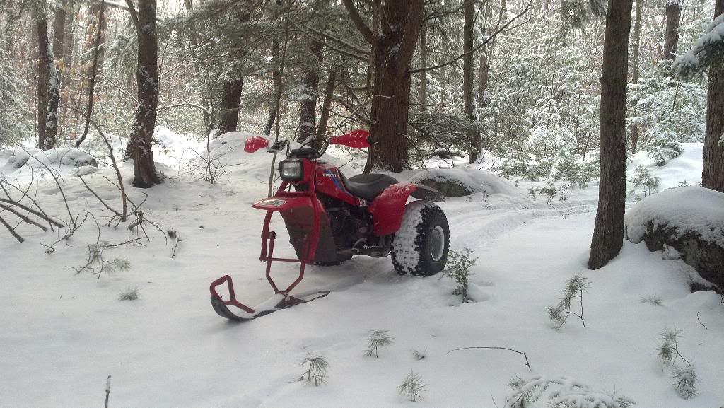

    here is the first part of my 3 wheeler snowmobile
    next up is to figure out a way to put tracks on it, i am thinking about using a snowblower track set up, but they maybe too small. something like this

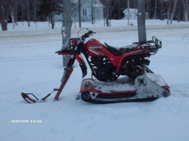

    few pics of mine,,,Bought it like that, don't even have a set of wheels for it,,LOL!!! Click image for larger version.
ID:	188290 Click image for larger version.
ID:	188291Click image for larger version.
    1986 Honda 350X
    1985 Yamaha Tri-Z 250
