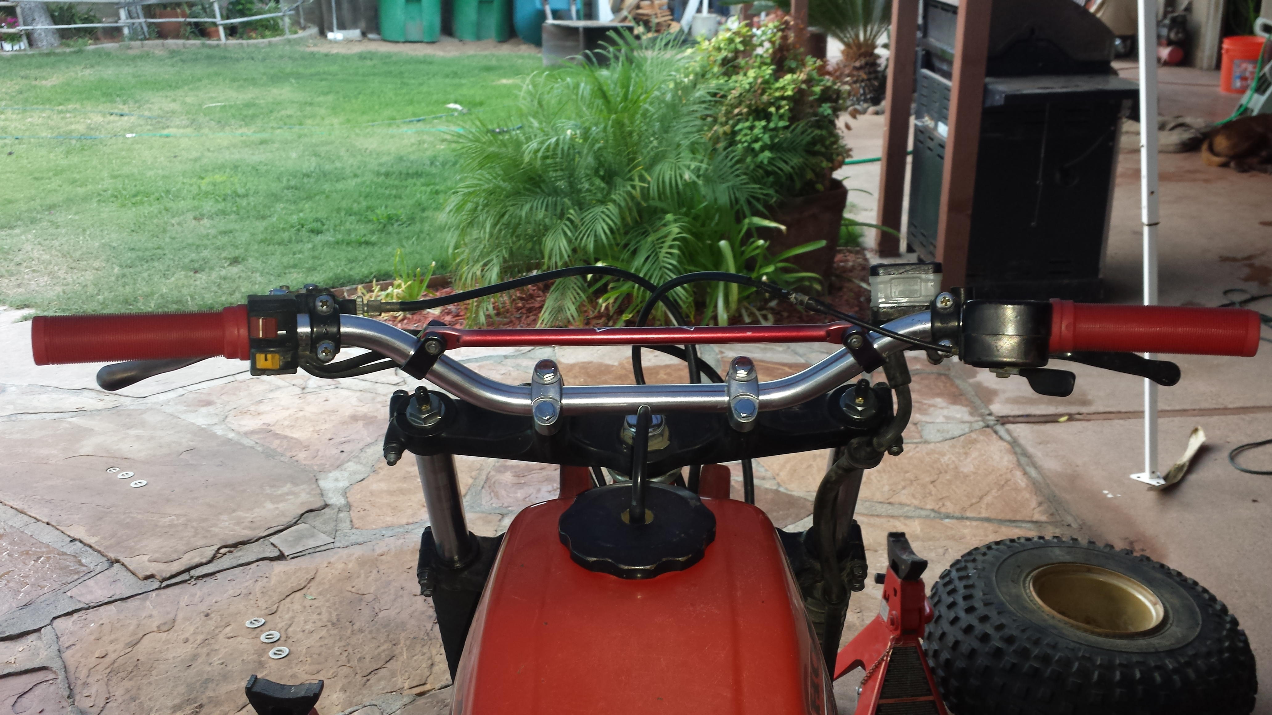

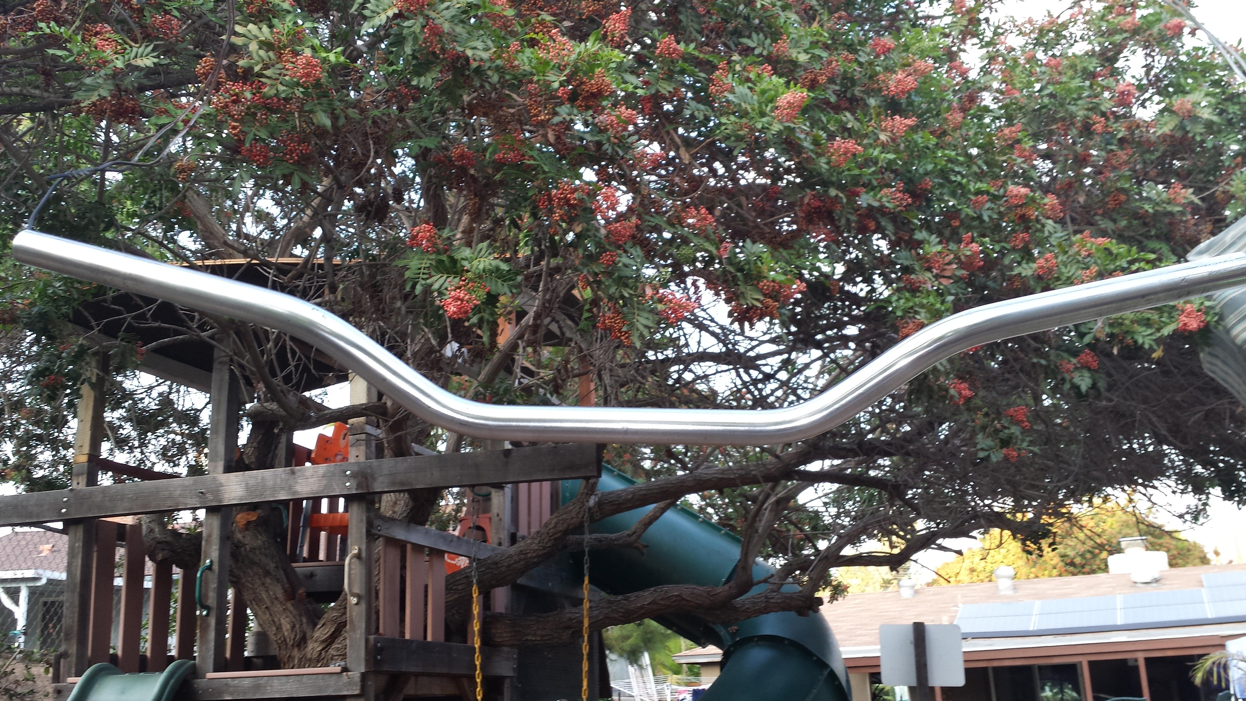

Finished polishing up the forks, gear shifter and Renthal bars, then put some clear coat on them. Painted the clutch cover black. Gonna let it all dry overnight and install after work tomorrow.
Paul from San Diego hooked me up with 5 bars to try. I really like the bars that match the bend of my motocross bike.
