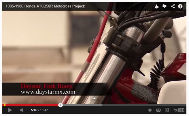

    Here is an example of what I was talking about. Looks like he had them dropped almost an inch.

    Quote Originally Posted by MPDano View Post
    For an 85-86 250R, that was how they were designed to be assembled by the Honda dealerships. There is a line scribed around the circumference of the fork legs that lines up with the top of the top triple clamp.

    Quote Originally Posted by Red Rider View Post
    Ahh, ok. So the 1st Gens are different?
    Las Vegas, NV.
    2,531
    Sorry, I don't know much about the 2nd Gen 250R's, and even less about the 1st Gens. In the magazine test of the '85 250R (most likely Dirtwheels) they said the bike exhibited a little headshake under hard braking. They mentioned how the forks were set up from the dealerships, so they tried lowering the forks all the way down, so only the plastic caps protruded above the top of the top triple clamp, and this seemed to lessen the headshake. My brother had an '85 & I had an '86, and we both lowered our fork tubes because of that test write up. We never noticed any significant difference in the handling one way or the other, but we only moved them 1". Unless you plan on going from one extreme to the other (completely raised to completely lowered), I doubt you'll notice much change in the steering/handling either.
