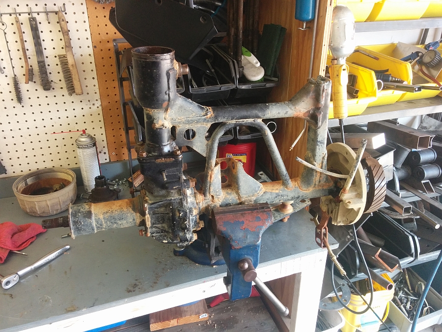

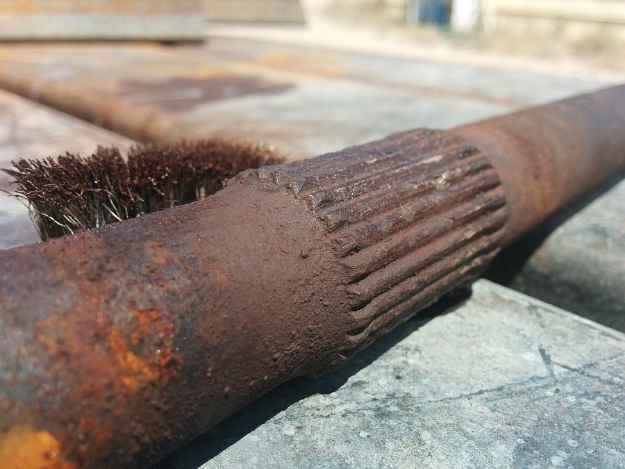

    Disassembled the spare rear axle. Exterior parts of shafts were definitely leaking and if the splines on this shaft are any indication of what's to come on the axle on the 250sx I may need a new axle shaft.
    The center section had no gear oil in it but it spines nice and smooth. The seal surface on the hubs still look good. You can see where the seal sat but there is no defined groove.
