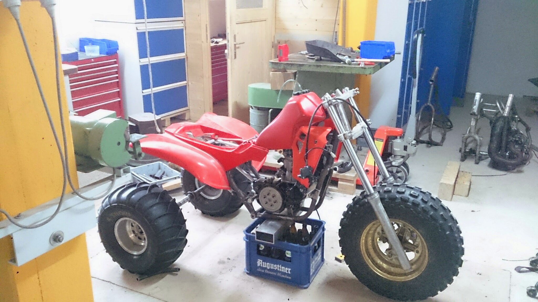

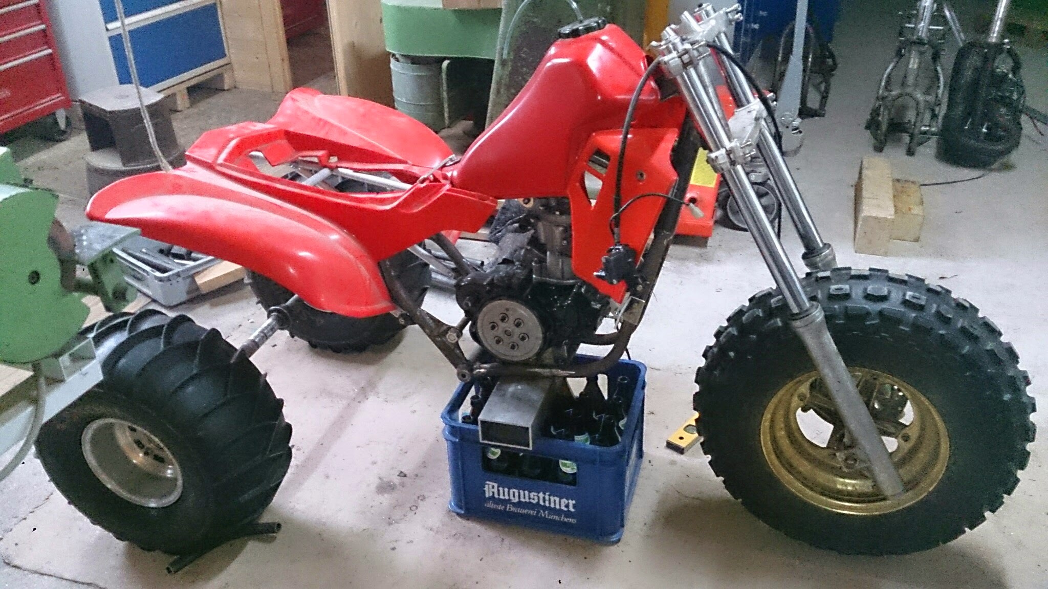

    Today i found some more pictures of the first mockup:
ID:	220484Click image for larger version.
ID:	220485Click image for larger version.

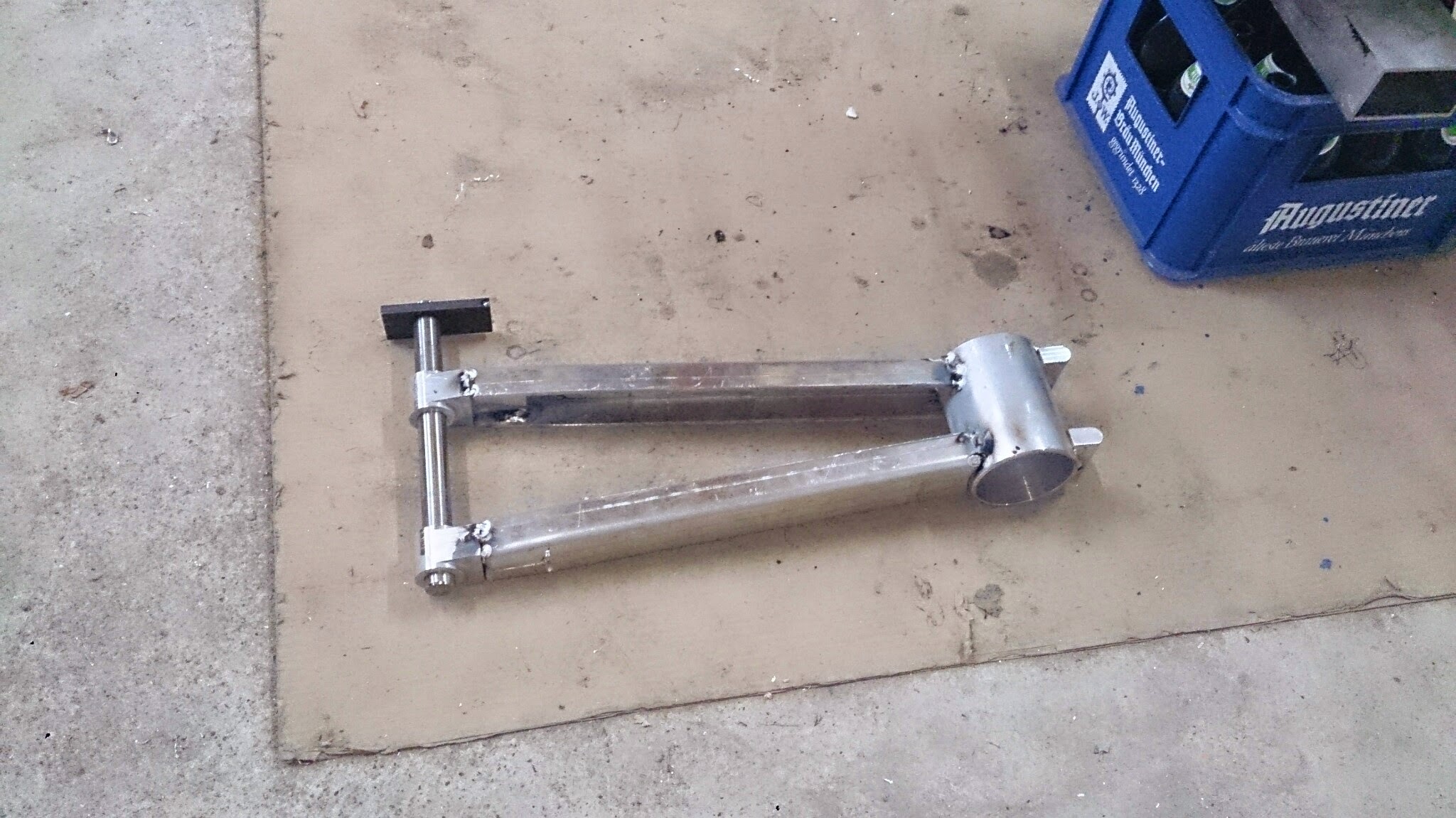

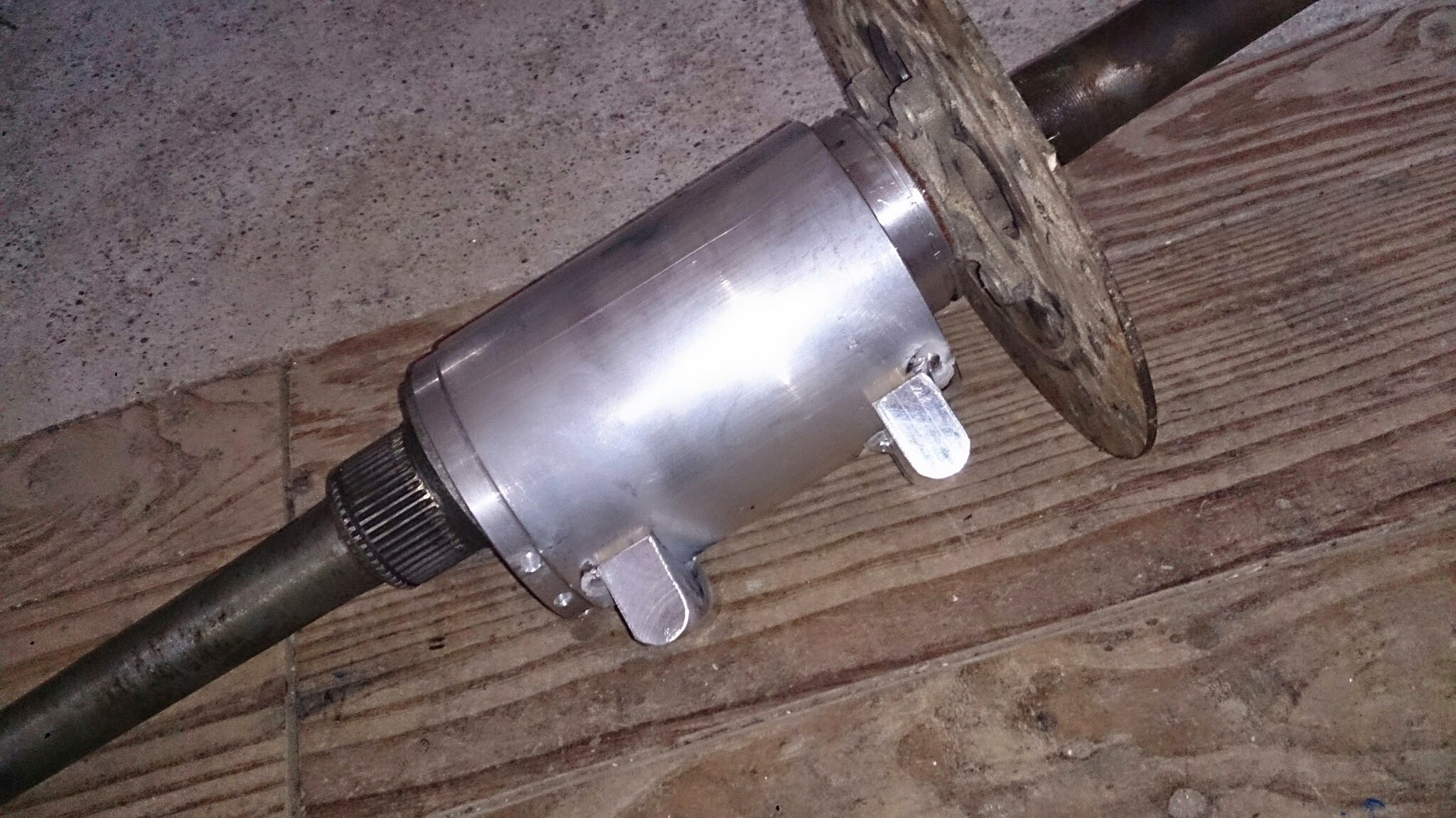

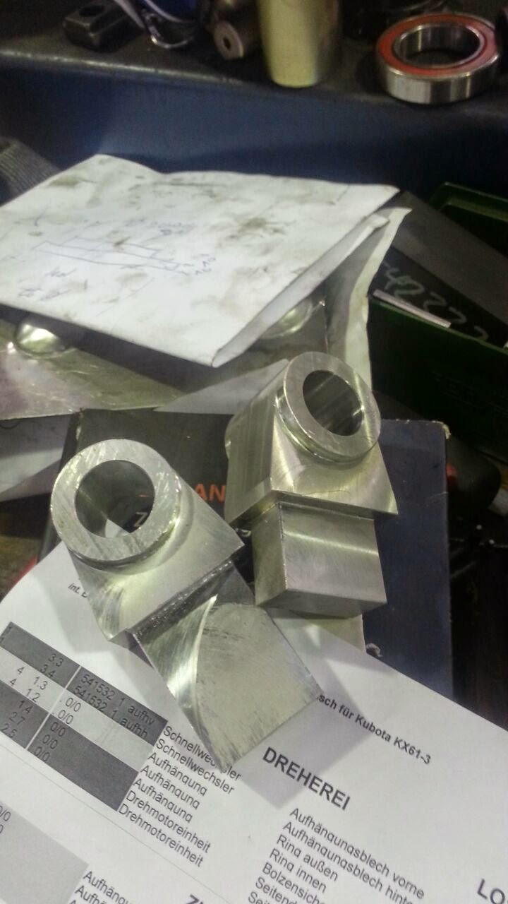

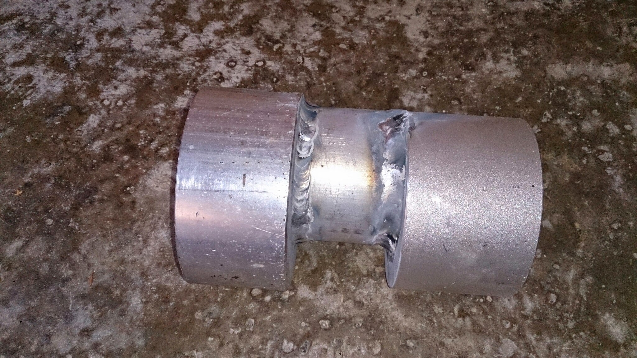

    The next step was to construct the swingarm. In oder to safe weight (and because i own a TIG welder) it was built entirely from aluminum.
    My swingarm was the prototype of Loizls...
ID:	220487Click image for larger version.
ID:	220488Click image for larger version.
ID:	220489Click image for larger version.
ID:	220490Click image for larger version.
ID:	220491Click image for larger version.

    The clutchcover came back from hard anodizing:
    That´s now my favorite coating for aluminim parts...
    To weld the swingarm straight an improvised jig was weld, (which was bullshit because parts of the jig got stuck in my bearring holes)
    For the nexts projects we will built an adjustable swingarm jig which is a lot more stable!
