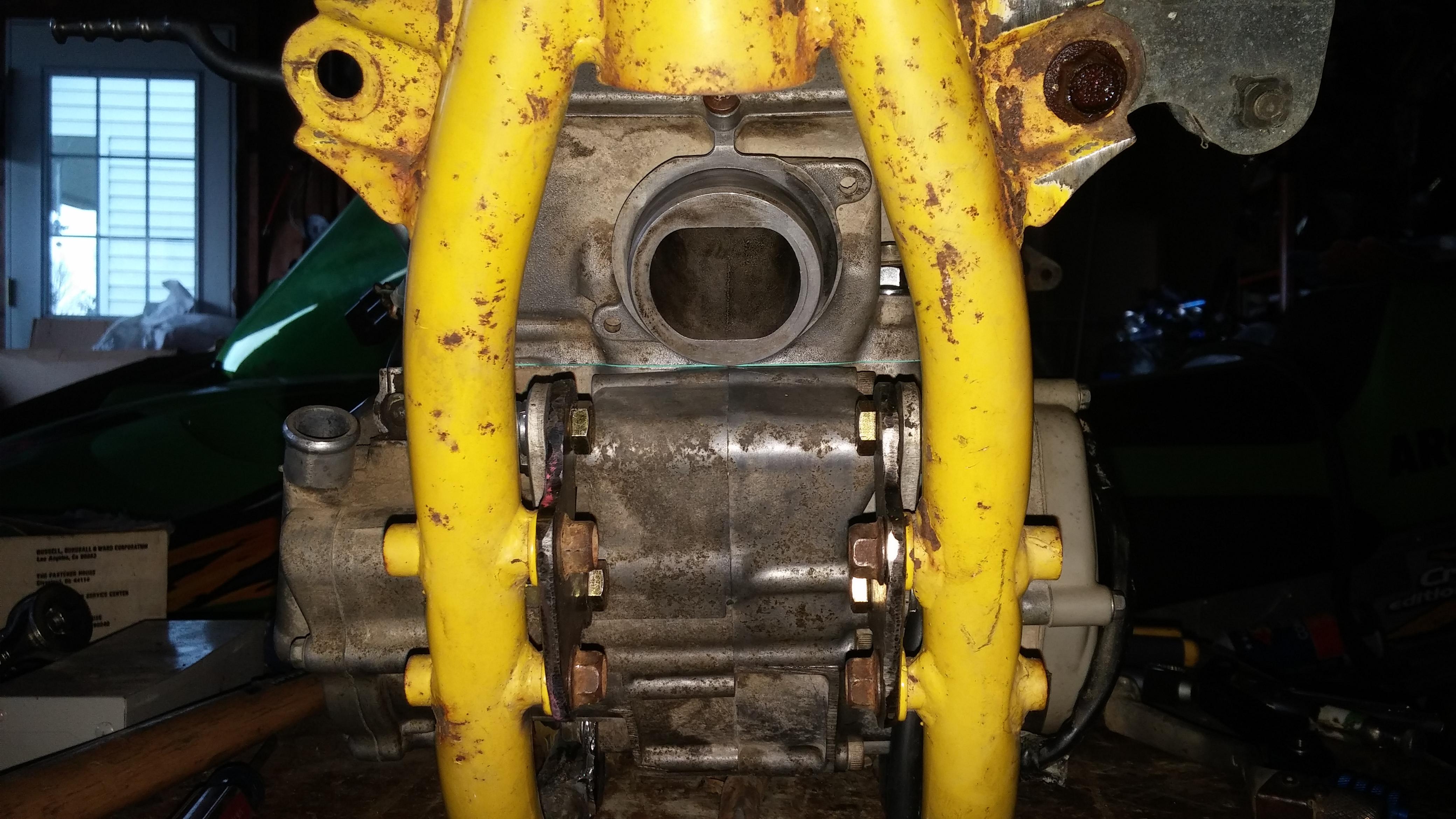

    The yz motor and triz case side by side on the garage floor, first things noticed are that the front case mount on the yz is a little wider than the tri z mount. Shouldnt be too big of a deal though as the way the triz motor bolts up in the front it uses plates that bolt to the motor on one end and to the fram on the other, should be able to make a set of stepped plates so i can use the stock front mount. As for the rear mount it is the same width and slides in the swingarm, but as previously stated on this thread by another member the front sprocket doesnt quite fall inline where it needs to be. It isnt off by much though, im hoping maybe the distance can be acheived possibly by just shimming the sprockets somehow, if not the swingarm will have to be shaved. I havnt actually set the engine in the frame yet to see where the bottom mount will fall.

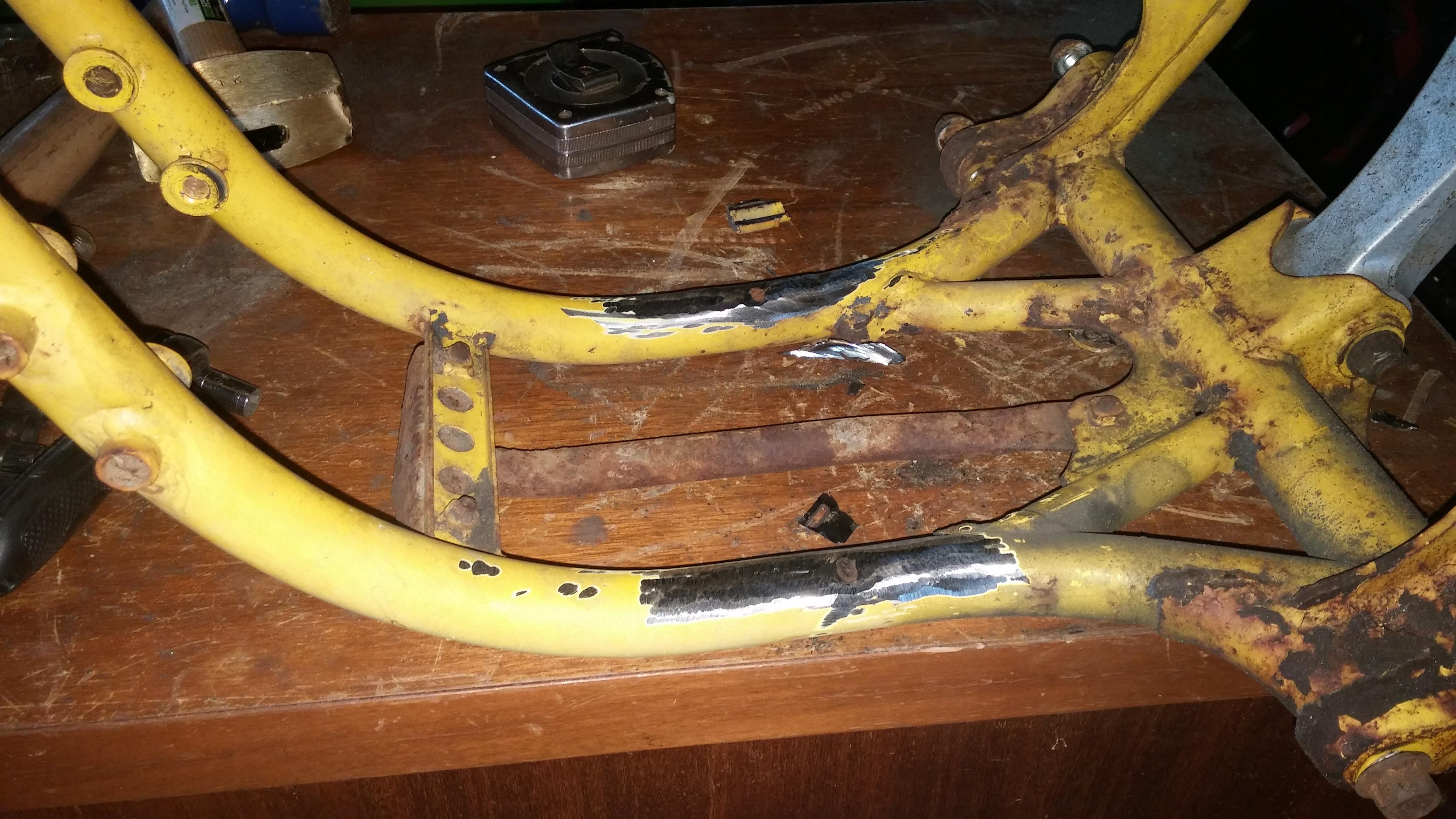

    Set the motor in the frame yesterday and started figuring out what needs to be done, also made up the bottom mid mounts and welded in place. Not the prettiest right now but ill get them cleaned up and itll look almost factory under some powdercoat. heres a few pics

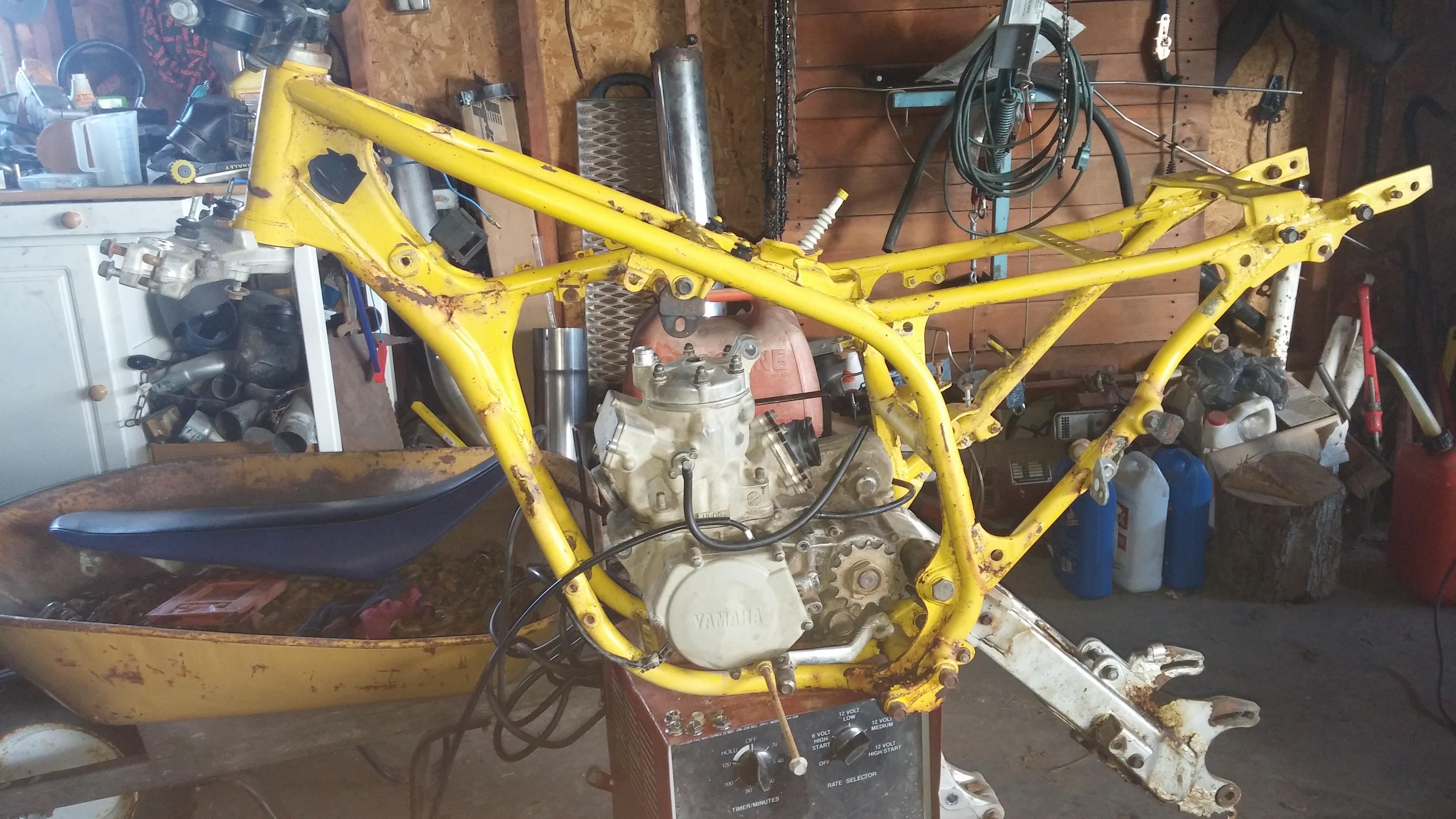

    Some more pics of progress. I got the engine all bolted down, made some custom mounts for the front and used the stock ones along with them, so far it looks like the stock radiators and where they mount will work with no issues. With the design of the newer engine the cylinder stands up straighter and creates quite a bit more room between the engine and the radiators
