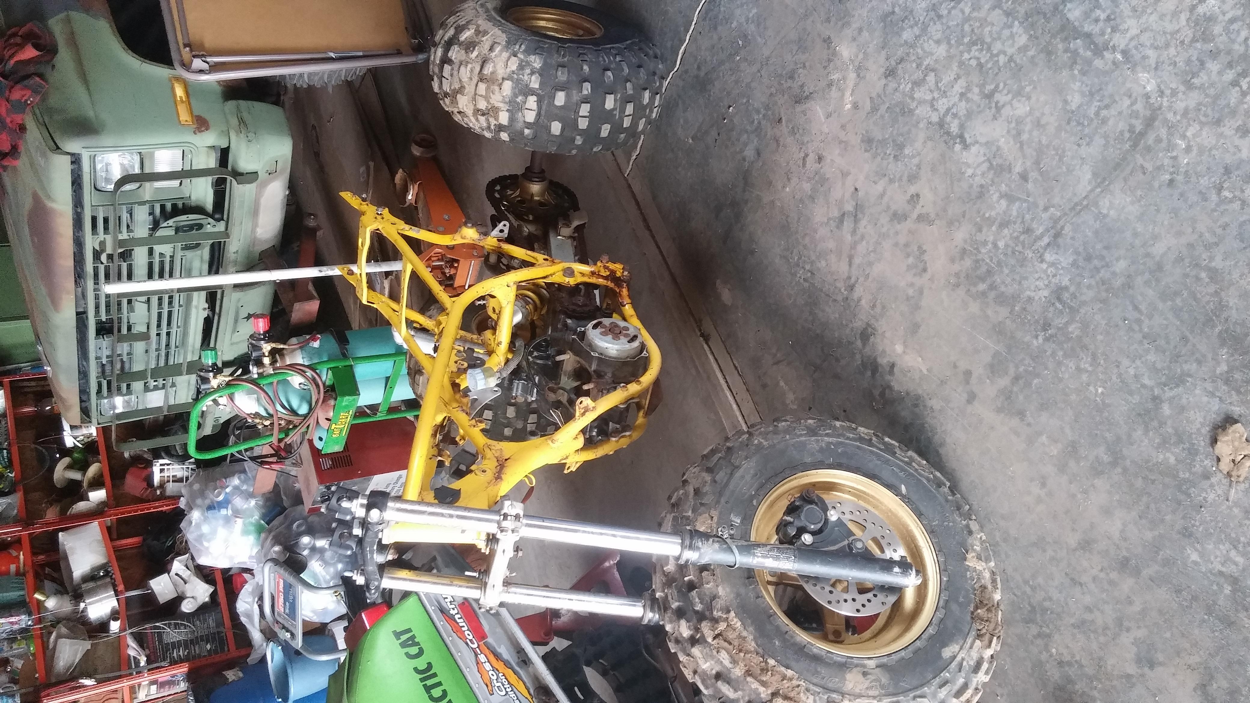

ID:	223373 the chassis im starting with is an 85, after many years of neglect sitting in a buddys barnyard with the topend missing i finally talked him into parting with it. Being that the crankcase was left open to the weather i didnt have much to start with here which is what lead me to wanting to run the yz engine in the first placeClick image for larger version.

    A modern yz engine is in no way a bolt in to your tri-z.
