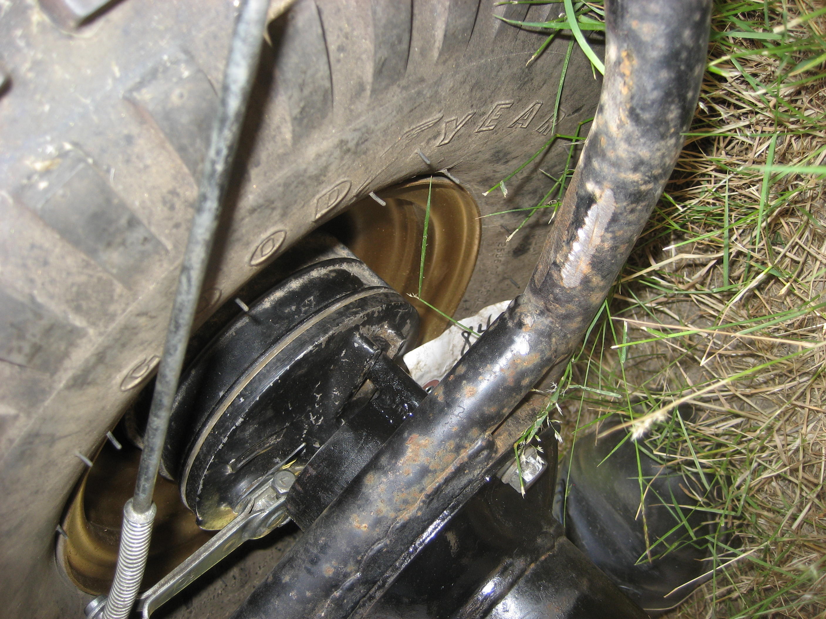

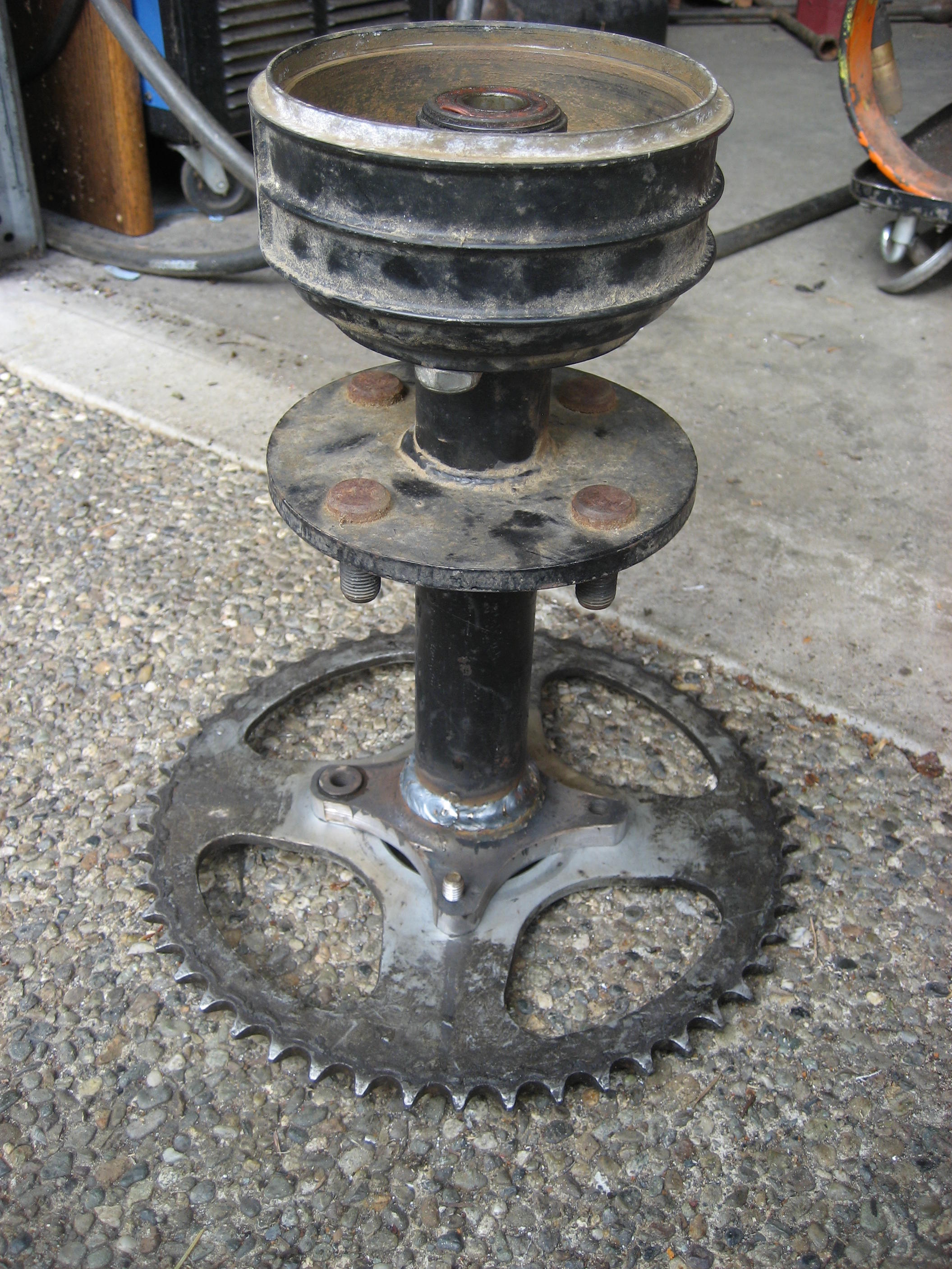

    Boonie Bike Progress Pictures
    Rear axle/ hub assembly.
    Yes that's an actual can of GOLD wheel paint. C'mon. This thing is legit.
    Brake 'stop'.
