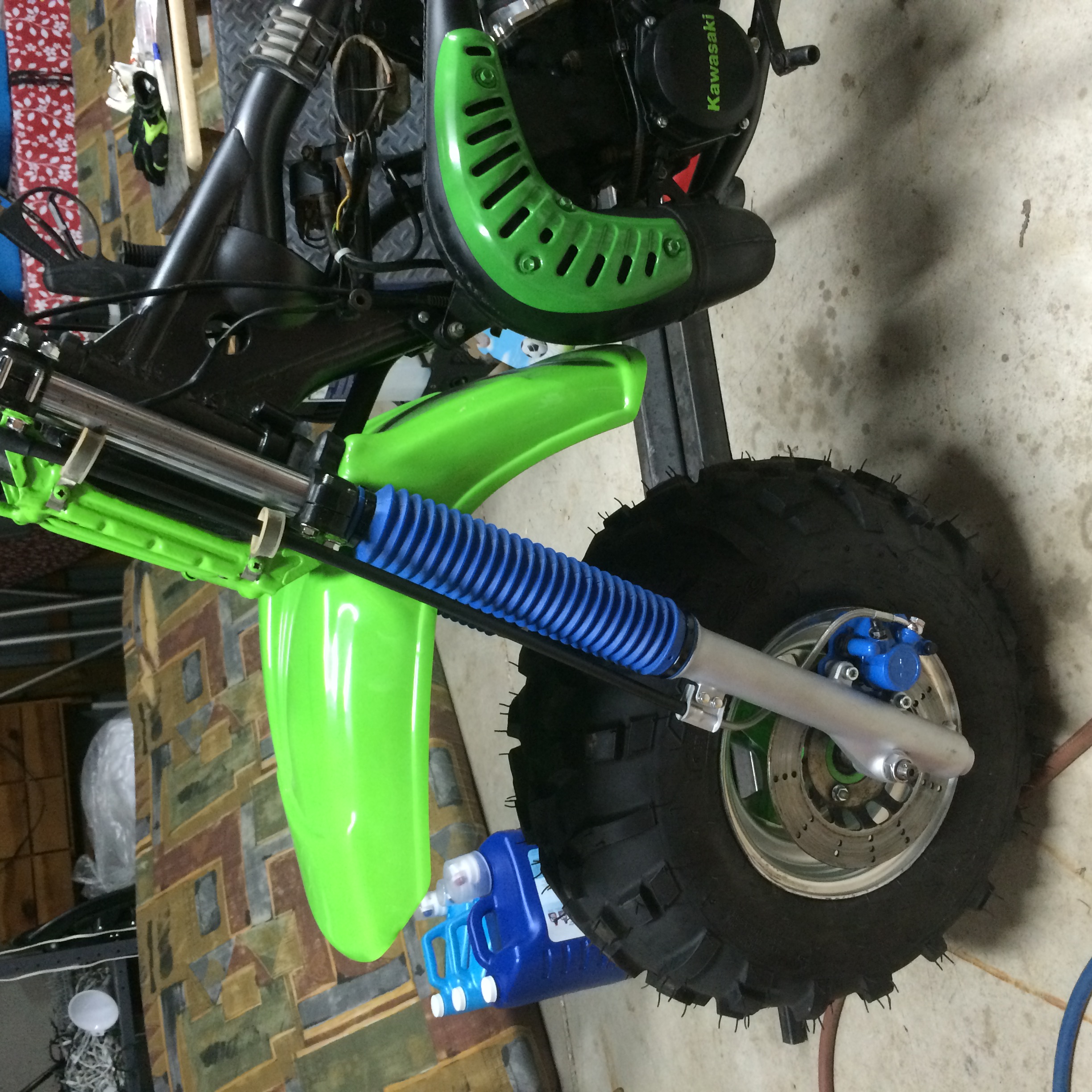

    Thanks for the good tips guys! I'm a goof, I thought I had cleaned the bleeder screw but turns out after another inspection that I only cleaned the cross hole at the bottom and forgot to clean the dried mud out of the hole down the middle. Goter' done now, took 10mins to have front brakes working great! Lol!
    I was able to finish reassembling the front end tonight, after fork seals and repaint the bottom of the forks.

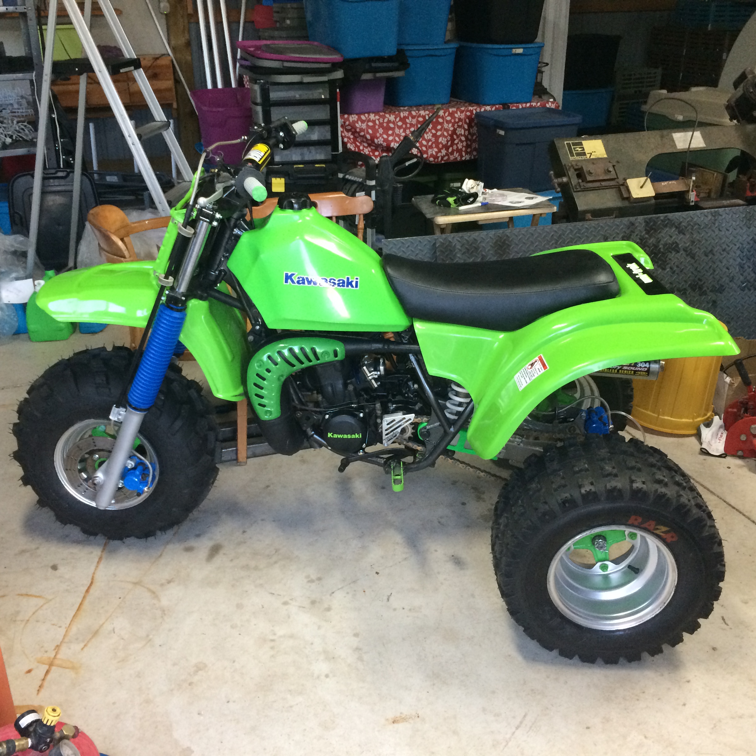

    so I figured out tonight what was wrong with my trike not wanting to run below 1/4 throttle as mentioned earlier. I decided to turn the idle screw in all the way until the spring was fully compressed and it ran better but still quit. So then I removed the spring completely and screwed it in all the way and it idles nice and ran sweet! Now, wondering if the plastic idle screw was shortened at a time or something? It measures 1.25" long from under the head to the tip. This is all I can think of why it has to be turned all the way in, is it has been shortened.
    At any rate I got to take her for a rip tonight for the first time and almost crapped my pants lol! I'm stoked!!
