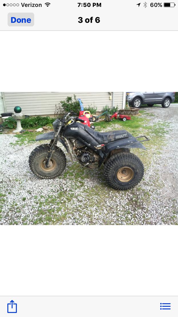

    Hey guys, I'm looking at a black and gold 225 DR and the seller says it's missing the reverse lever. Is this something I can easily get or maybe fab up? Any suggestions are appreciated.

    It's pretty rough and doesn't have a title. I was thinking $3-400. But idk if he'd take it or not.
