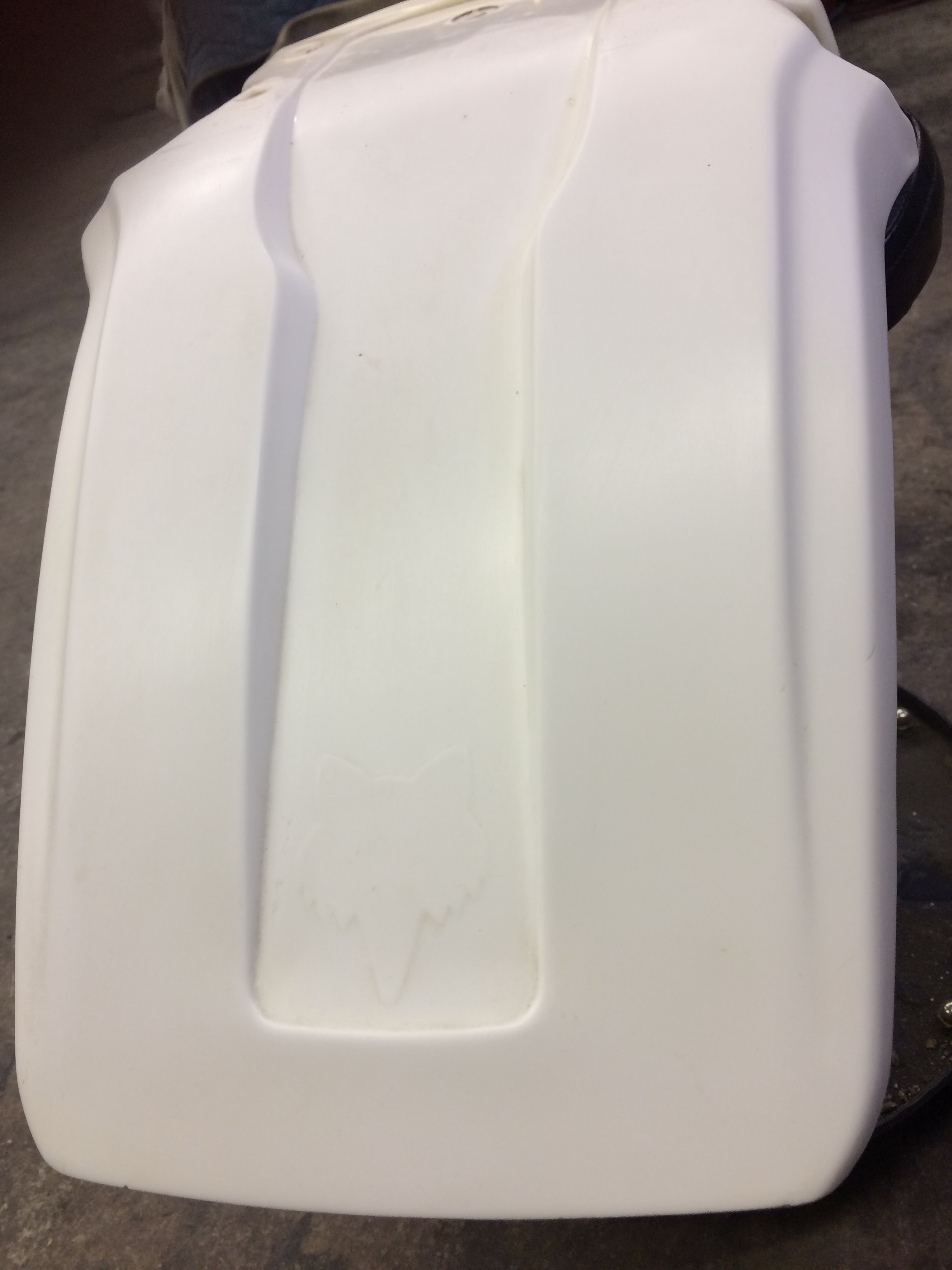

    I have a 1986 TRI-Z with white front fender. On the front of the fender is a FOX Racing logo. This is not a decal. It is not pressed into plastic it sits higher than flat surface and is part of the plastic. Any info about this is appreciated.

    That fender was deteriorated by the sun and the decal protected the plastic underneath it causing a raised effect.

    Yes same thing happened to my kids mini quad.

    Yeah bkm is right. Anyone know a way to remove that?
    I don't know why you'd want to but you could sand it off.

    All above are correct answers. Steelwool and brake fluid will work also. I have ufo on my yz fender sun fades and shrinks plastic when exported to long term light.
