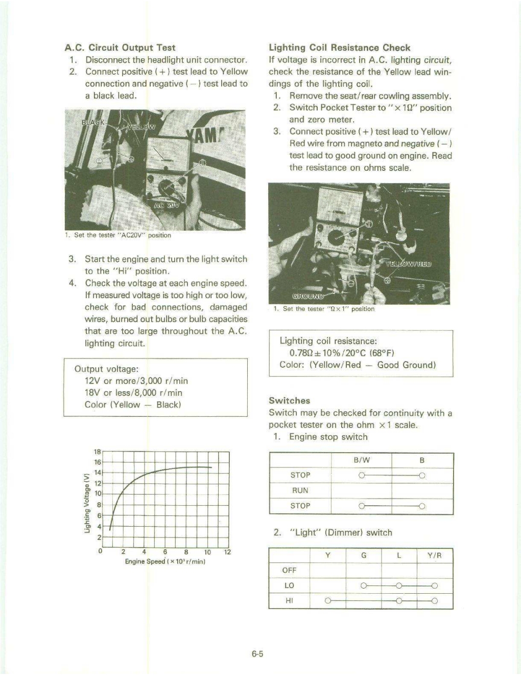

    Yamaha tri moto ytm200k blowing head light bulb
    Quote Originally Posted by MonroeMike View Post
    Testing procedure.
    That's great! Thank you, Mike.

    Thanks guys I will have to find a meter that will test a/c current as mine only does d/c . What would you recommend?
