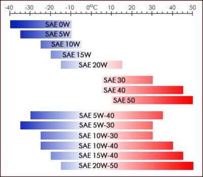

    Good point barnboy. Dont buy regular car oil from walmart get an oil made for powersports w/ wet clutch. personally I use polaris but any of the name brand synthetics will be good oil. Like DAM said weight/viscosity depends on the climate. Heres a chart for you.
    note that the temp scale is in C

    Oil for a wet clutch, oops didn't know that Indy.. what's the difference? I've always used regular motor oil.
    Mar 2008
    Tug Hill
    1,282
    All oil that is wet clutch safe will be marked on the back with JASO MA. Im not sure if there are other differences but car engine oil for example doesnt have the additives needed for a wet clutch and can cause slippage. Had a buddy that changed the oil on his banshee and used cheap pennzoil from the store and as soon as he changed it his clutch started slipping.
