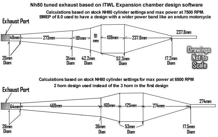

    this picture might give you an idea but to really understand how 2 stoke exhaust works takes a lot of reading and practice.

    that long as diffuser is definitely for low end. generally a short stinger is for topend long for lowend kinda obvious you want more back pressure for lowend power less for topend. but thats just the beginning you still have the header, diffuser, size of the mid section which is mostly for volume and the baffle. when i say baffle im assuming you know i dont mean the core of the silencer right? are you totally lost yet? then you need to know if your going to go with a single, dual, or triple stage diffuser and a single or dual stage baffle. some people have made triple stage baffles but you dont really ain anything over a dual stage. really lost yet?
    i know what the hell im talking about dude ive built over a dozen sets of pipes for my watercross sleds alone.
