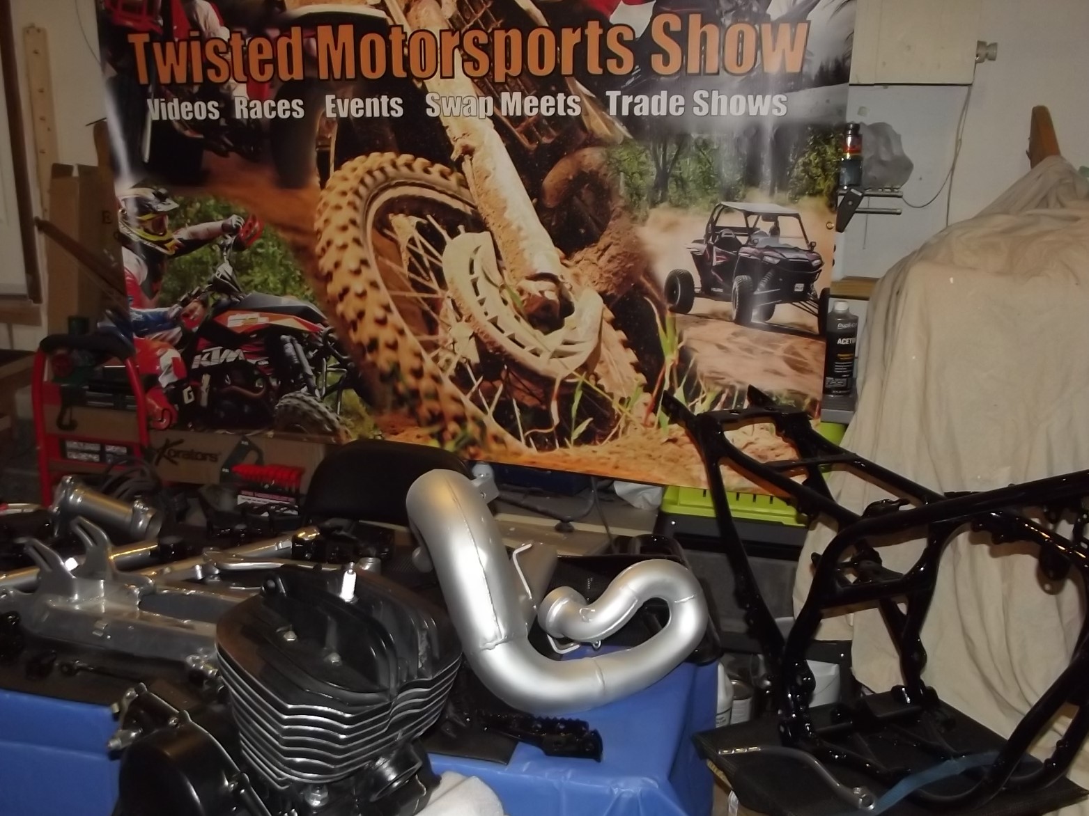

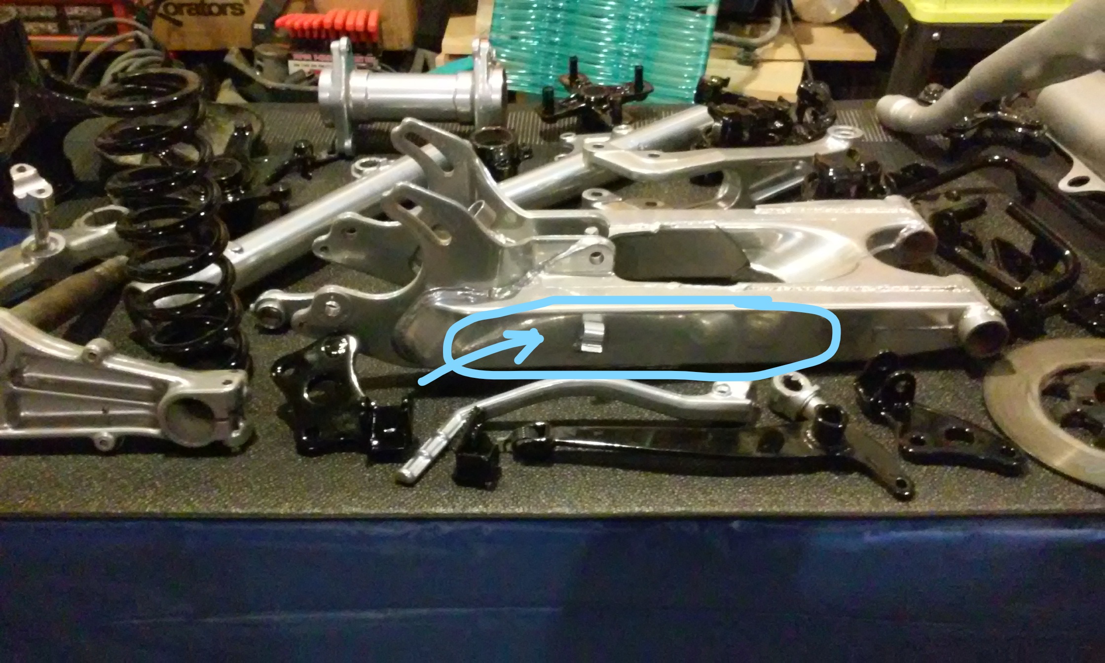

    My 86 Tri-z has been with me for 30+ years now and its time to preserve her, but I still need a rider...so I am building a Tri-z490. This past weekend I picked up the completly rebuilt engine and the powder coated parts/frame. I went with a gloss black and Chrome Look with a mirror finish. Definetly not polished chrome but does have a mirror finish an I have to say I am extremly happy. Check out the pics. I will post more pics soon as she is being put together. Can't wait to ride her

    kept her stock for now. Plan on doing some head mods next top end, they say it helps to reduce detonation. The pipe, carb and reeds are aftermarket. The motor mounts I had custom made and the sprocket needed a 26/100's offset so had that made too. I heard from Raffa he runs stock sprockets so I can save some money in the future. The sprocket I had made is a work of art. I will try and get that up next pic. The motor really is a drop in like Yamaha planned on making a 490z.
