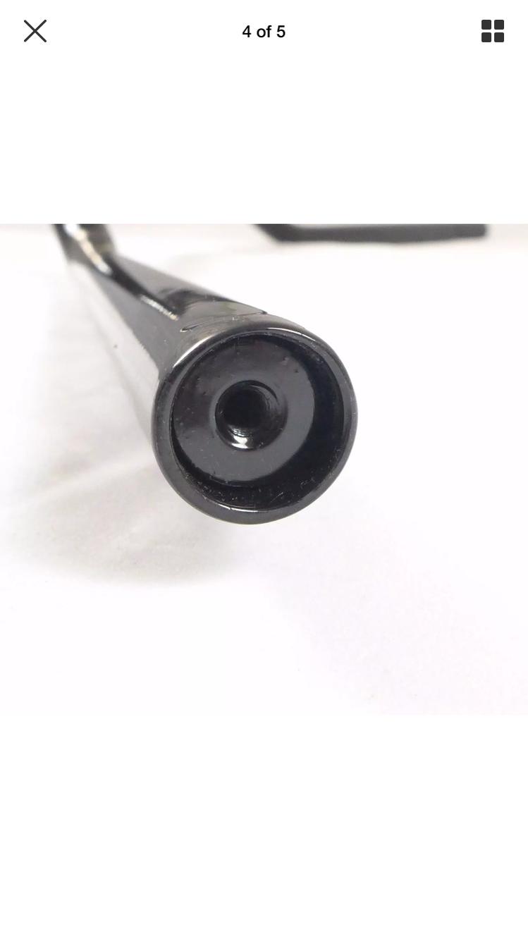

    Any bar listed as an ATV bar has the knurled area across a wider section and are a bit longer in the clamp area to make them compatible with the wider spacing found on ATC's and most ATV's. As for the threaded insert for the end caps I think your best bet is to find an OEM one off ebay, but I've never received one that wasn't at least a little bent. If the ones you have are not too bad you can usually bend them back using a long pipe for leverage.
