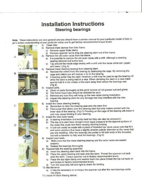

    This is what AllBalls sent me, although you may have to download it to your computer and blow it up to read it clearly. Your top race should go in the neck (ed in with a piece of wood) tapered side UP. Run the fork stem up through the neck, and just slide the top bearing down. The bottom is the headache, the top will just go on. I've installed three sets of tapered steering bearings, and all three races did not seat fully in the top.
    [IMG][/IMG]

    IDK what machine your doing this to? But the 350X does not want the washer, you run out of threads on the upper bearing adj. nut.
    You have the option of pressing out the hole stem and starting over.
    With a bare stem, it goes, sealing washer, lower bearing, upper bearing and adj.nut.
    The instructions are not model specific and screw allot of guys out of a proper install (and money).
    My trick is to remove all the stock stuff (balls and all) and stack it up, then measure the height. If it's close to the new stuff, don't use the washer. If the new bearings stacked up are quite a bit shorter, use the washer.
    When pressing on the lower bearing you have to center the seal or that will get damaged as it doesn't fit well either. The washer (if needed) goes on first, then seal, then the lower bearing.
    I've done them all that way.........
