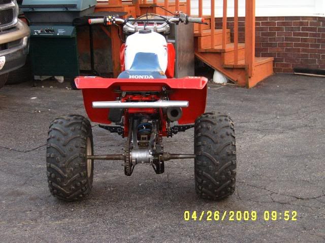

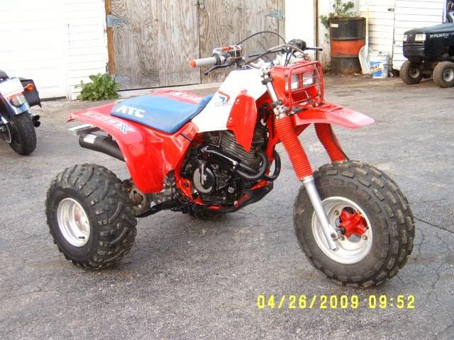

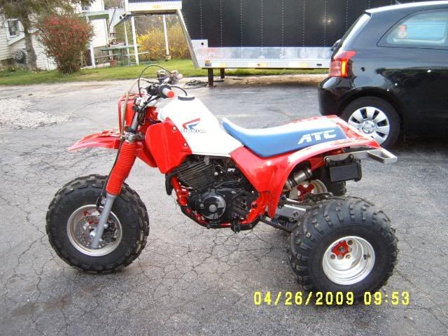

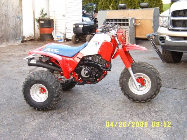

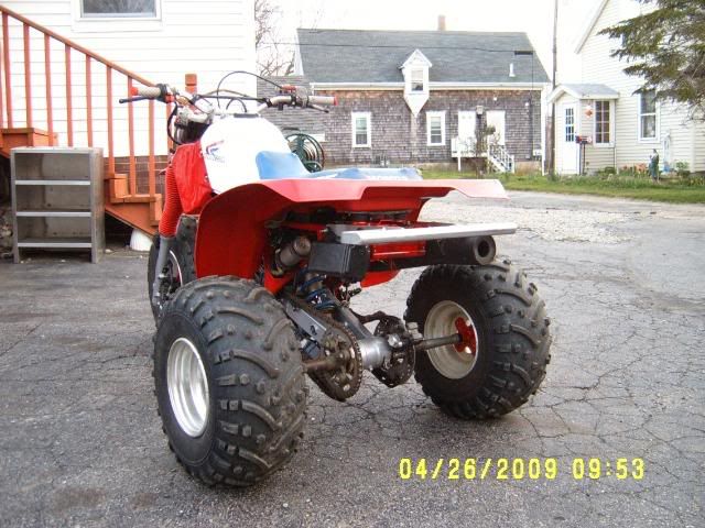

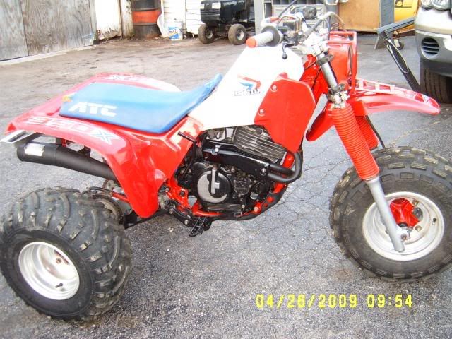

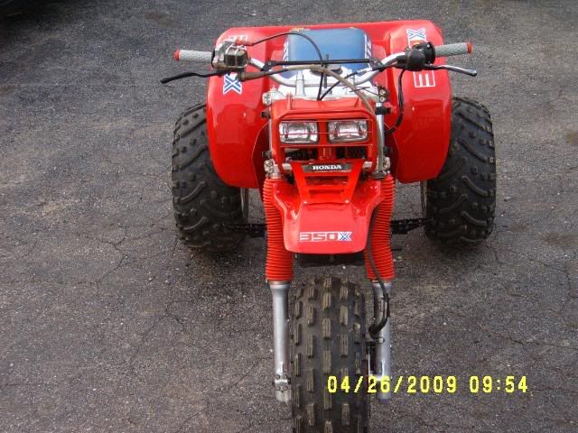

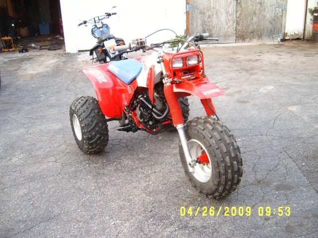

    I worked on my X for quite a while today just tieing up some loose ends I indeed got it finished. Here are the last pics of the build,, enjoy!
    I'm very pleased on how it came out
    I want to thank everybody involved, in making this build possible!
    DC,, YOU ARE THE MAN
    Jeff,,(honda250sx) thanks for the bearrings
    edog for all the parts
  4. #109
    17,462
    I'd say the frame, headlight guard and the right side up carrier are the best points
    Nice job Roy, hope it's freshened up good enough for you because thats ALL that matters!!
    EDIT - That front fender stay came out sweet too!! Just call me "BENDER"

    The only thing that i forgot to do is swap the rear tires back, so they're facing the right direction

    The only thing I don't like about the Maier rear fenders is, how the kick starter has a tendency to swing open, where the OEM rears has the notch molded in for the kicker to stay closed

    Wow, Roy. That didn't take as long as I thought it would. Nice job.
  10. #115
    Apr 2008
    somerset ma
    1,822
    Thanks John, I guess like George McFly said, if you put your mind to it, you can accomplish anything I worked on it for around 30 hours between friday-sunday

    I love the front on shot! nice build for sure! did DC fab that fender support? or just pc it. When you recover the seat go red, It will look sick, and unique! You can freshen up that axle easy without taking it out. Use a wire wheel on a angle grinder to get the heavy rust off, then raise the rear end, put it in gear, and take a fine grit scotchbright and wrap it around the axle moving back and forth from wheel to swinger, shines it up nice! spray it with some clear, or just keep it lubed with some wd at all times. Just be careful when doing this, its easier with another person, and safer!
    Thanks for the compliment DC didn't fab the front fender support, I picked up a used fender that had it. It had a few bends and tweaks. DC straightened it and re powdered it.. As far as recovering the seat in red, I'll keep that in mind

    Quote Originally Posted by MonroeMike View Post
    Nice job. I like the front shot also.
    Thanks, The front shot is one of my favorites as well
