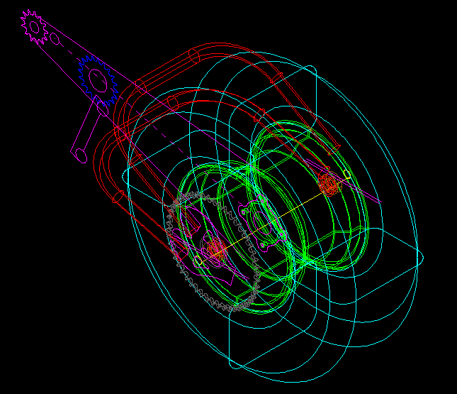

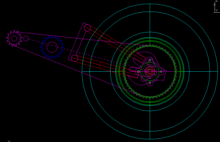

    Here are a couple CAD screen shots for you to see what the rear end will be like...
    Obviously I don't have it all figured out yet, but getting close. For reference, the two bent tubes that create the swingarm are 1-1/4 x .058" CroMo tubing.

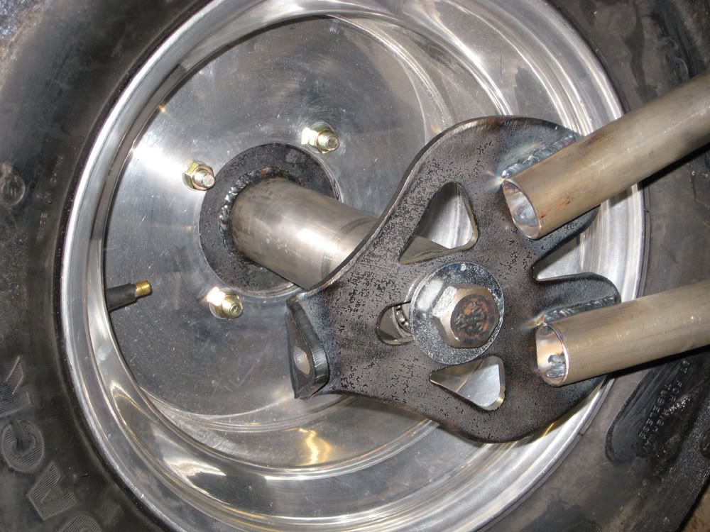

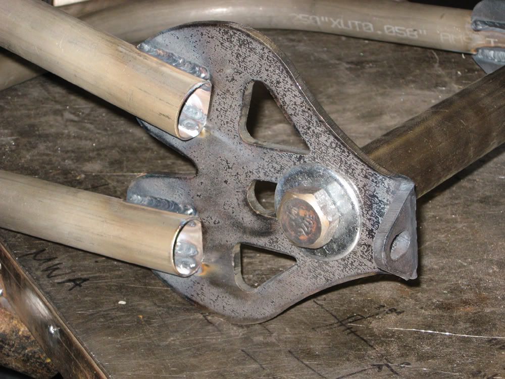

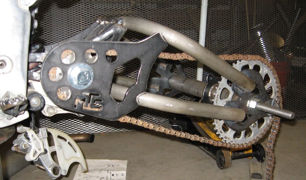

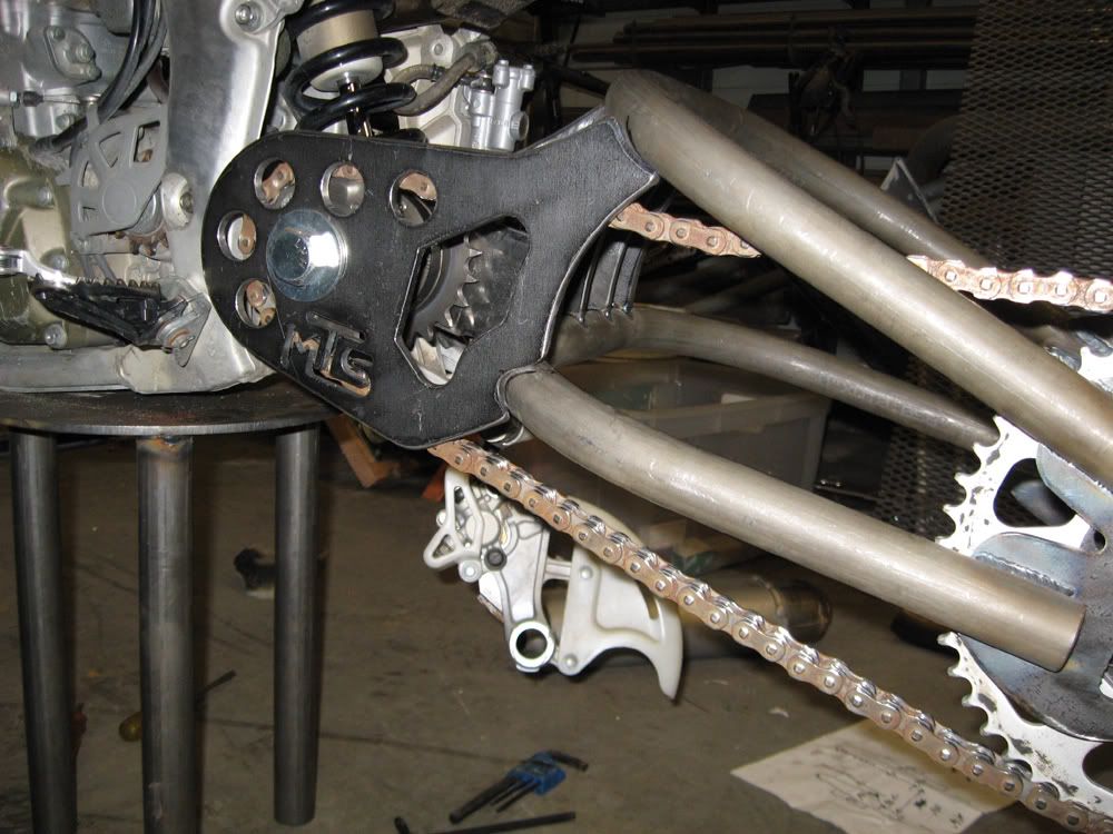

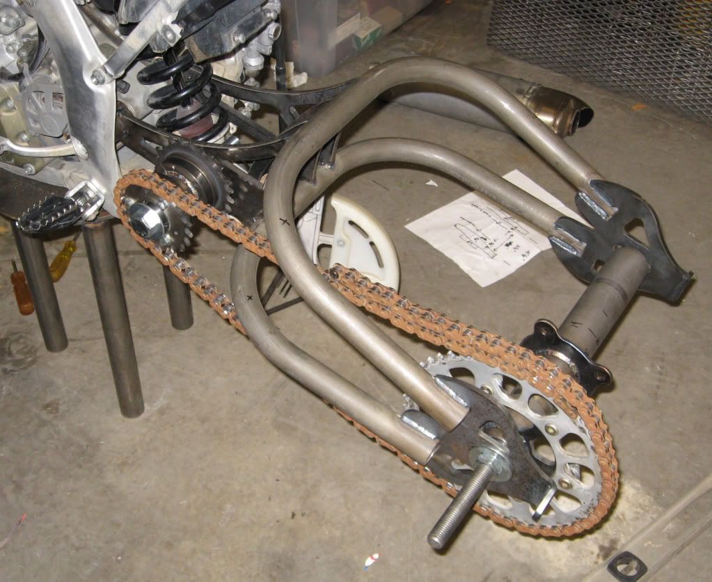

    I've made some progress on the rear end, here are some pics to prove I've not been sittin on my a**... LOL...
    I bent two Cro-Mo tubes and cut out some dropouts to hold the rear axle/hub assembly. I also started the rear hub and have the flange to hold the wheel in place. Still need to make the flange to hold the rear sprocket and disk rotor. I will create brackets to attach this swing arm to the pivot point on the frame of the motorcycle and brackets to hold the jackshaft assembly.
    XS Energy Drinks and more: www.mike2you.com

    Nice fab work (wish my beads looked that good too).
    OK
    5,450
    Keep it up, awesome work. Are you keeping the measurements/plans for this? So you can make another one?

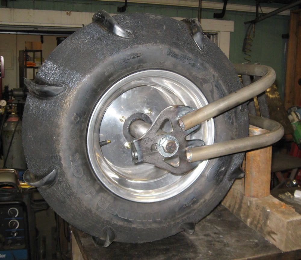

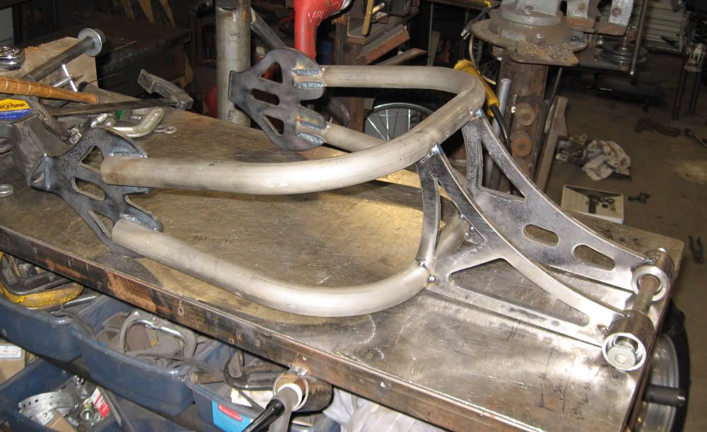

    More Progress!!! It's coming along nicely..

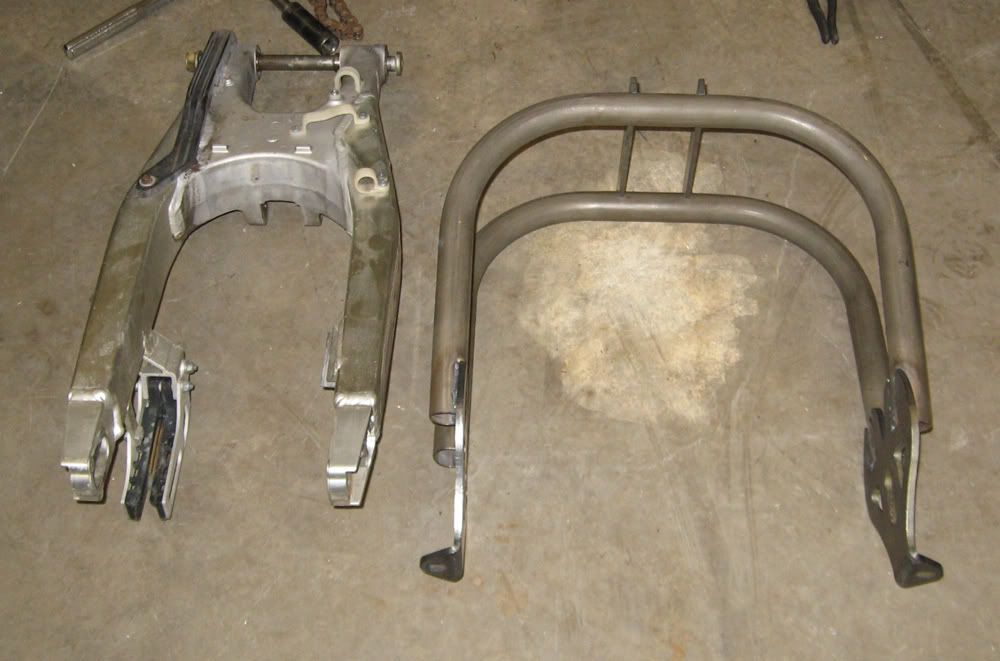

    Tearing down the rear end of the bike....
    Compare those swingarms....

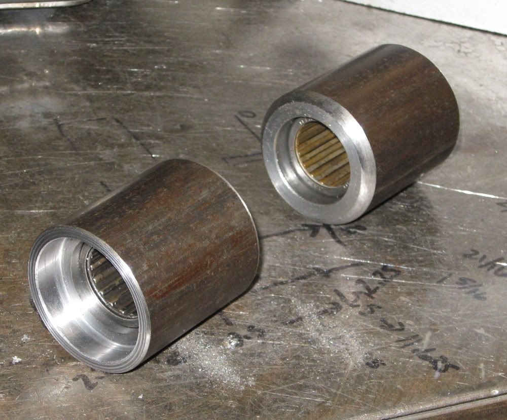

    Swingarm Pivots to fit stock bearings and seals..

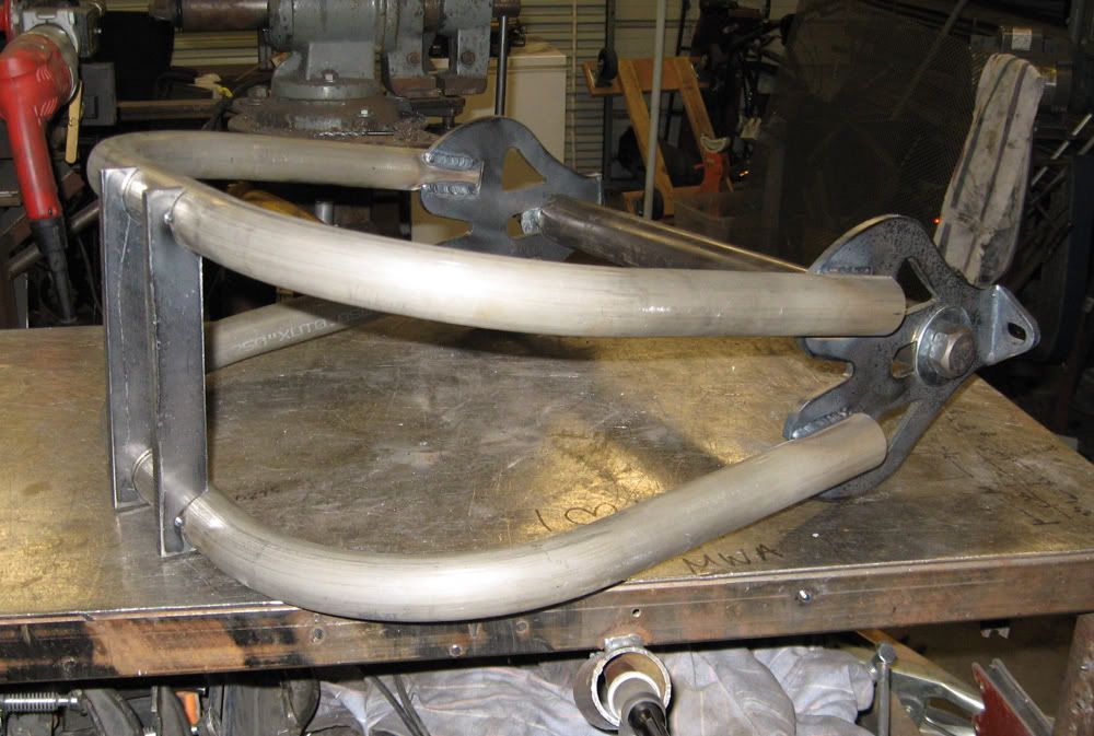

    Swingarm with Pivots tacked in place.

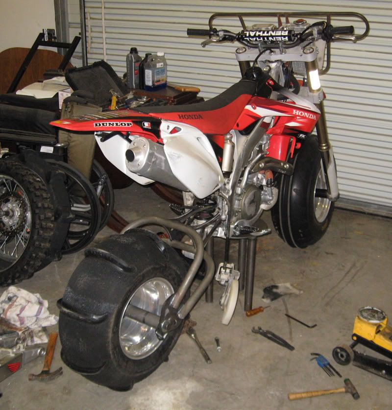

    Swingarm in place.
    Just had to throw the wheel on there to see what it looks like!!
    Working on the shock linkage mount.
    I'm sooo addicted to this project, who needs sleep anyways right??? LOL....

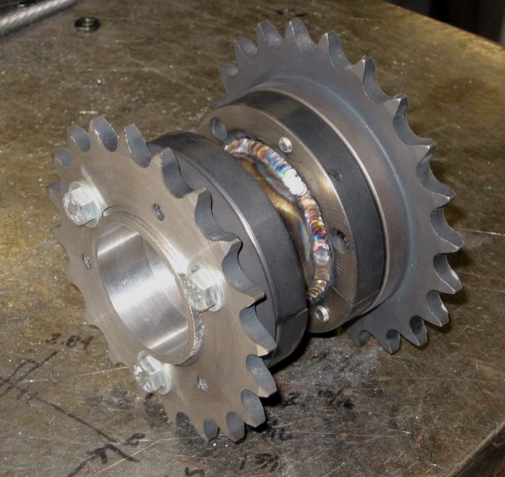

    Well, I got some more done this weekend. Jackshaft and rear sprocket mounted!!!
    Jackshaft made.
    Rear sprocket mount made.
    Now things are going slower, it's always the little details that take the longest!!
