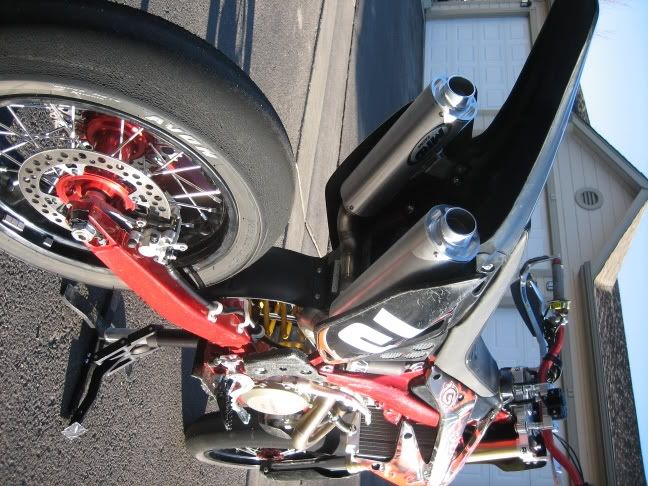

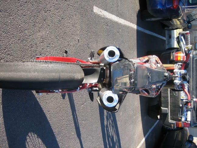

    Ok, finally got it ready for it's maiden voyage!! Heading to South Jetty in the morning....
    Got the exhaust figured out.
    Re-worked the radiator guard and powder coated it white.
    Finished front end.
    Swingarm and rear hub all welded.
    Powder coating the swingarm.
    Johnny 5 Silver!!
    Powder coated rear hub.
    All ready to throw some sand around tomorrow!!!! Wish me luck!!
    XS Energy Drinks and more: www.mike2you.com
