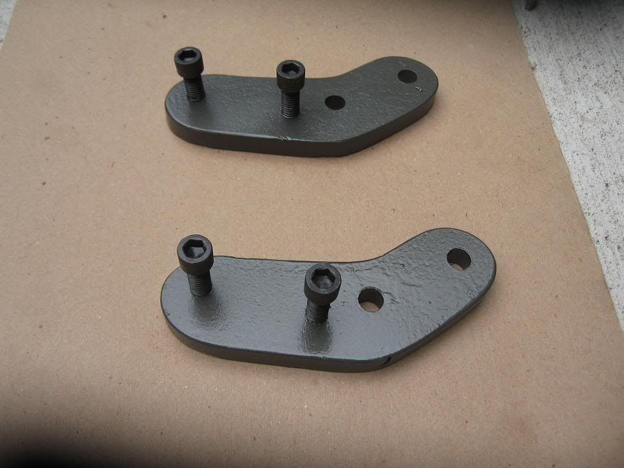

    PM Jason Hall. He sells adaptors that accept 450R pegs and bolt directly to your bike for $29! 450R pegs are huge, solid and cheap!

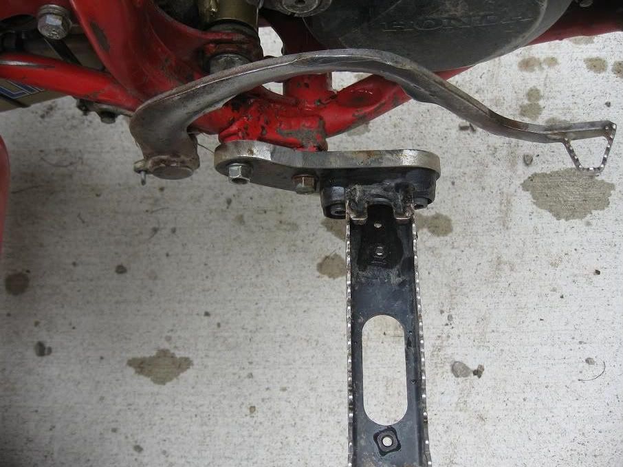

    I realize this is an old thread, but I have these plates to mount 450R pegs on my 250R. I bought the 450R Blingstar pegs. The Blingstar pegs mount like 3" + away from the mount flange leaving a big gap.. Why would the Blingstar 450R pegs look so much different than the stock 450R pegs? I may have overthought this..

    I assumed (yeah, I know) that trx450 pegs would mount and be positioned the same regardless of if they were oem or Blingstar. Apparently, Blingstar decided to space them out 3" from oem. I don't understand why they look so different. The footpegs are almost as wide as the fenders.

ID:	117711I am glad the adapters got there that quick for you. Sorry for the crappy phone pic I just ran out to the garage to get a shot but my roll design pegs look like they stick out just as far as the blingstar pegs you got. Also with the kick up at the end they are as wide as the fender.
