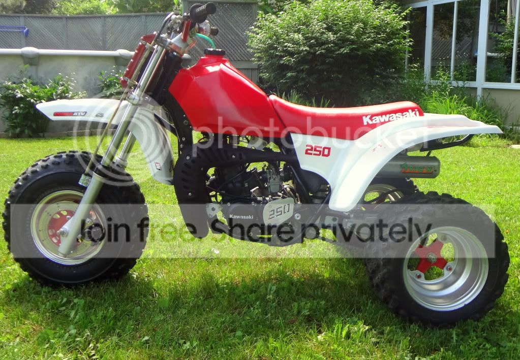

    Quote Originally Posted by RoscoW View Post
    Did a couple Tecate's. The green one is still floating around Ontario in a collection near Oshawa and the red and white one was sold to a fellow who passed a couple years ago and I'm not sure where it ended up. Found that I would always bring one with me but always chose to ride the Honda. Yours is looking really nice, great attention to the detail items makes for a really nice build.
    Ross..
    Green Tecate build thread
    http://www.3wheelerworld.com/showthr...-in-the-stable
    White and red Tecate,
    Wow! nice tecate!
