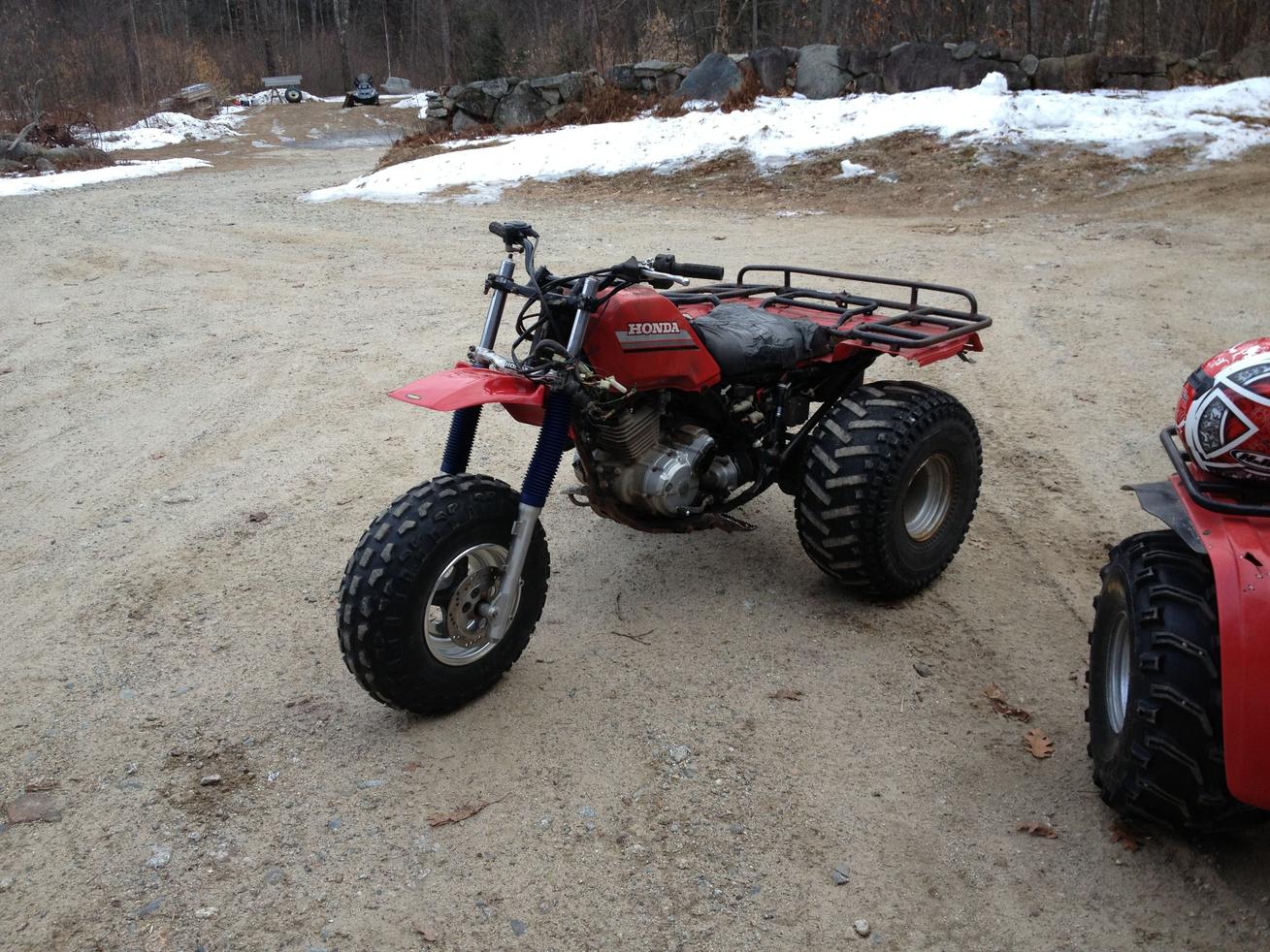

    So, over the past two months I have been sinking money into a great running 250es. I paid $200 for it. The rear fenders were mostly cut off with a saw and the front forks were bent. It crashed pretty hard in the front. I was still able to ride it around and its definitely worth fixing up. So I put a 350x front end on it which was pretty easy. I had to buy all the parts individually, (forks, triple tree, axle, hub...) I eventually need to get a caliper and master cylinder but first I need to figure out a headlight. I have looked every where including ebay and can't find a headlight setup for a 350x. Does anyone have one or know of an alternative, like will a 250sx headlight strap right on?
    Also, is it possible to put rear fenders from a 250sx on my 250es. The reason being it would be cheaper than buying the two fenders, trunk and and those impossible to find side panels. Also I want to put the vinyl camo kit on this and I think it would stick better to the sx fenders.
    Thanks

    fenders wont fit without alot of modifications...

    agreed, they won't fit. also, i've heard nothing but horror stories about those camo kits. bubble city. keep it red.

    Post up some pics of your BigRed!
    Pretty sure 250R and 200X will work for a headlight setup. 250SX headlight shell is wider, but seems I read some stretch the straps or turn the straps to make it work.

    Pics please!

    Thanks for the tips. Another thing about this wheeler that I don't understand is its power. I can pull wheelies in 4th gear. You throw it into first at a low idle and the front end jumps up off the ground a couple inches. Its an 85'. My buddy has an 86' same machine that is in mint condition, runs great but wont lift the front end in any gears... I just think its strange. I told him he probly needs new centrifugal clutch shoes. What do you guys think?

    By the way, this 350x front end was worth the money and time i spent waiting for the parts. I love it and it bolted right on. Still need to weld the new stops but it rides great

    Looks awsome i was thinking about doing that front end swap to mine but it would be pretty pricey and mine is good to go now and kinda like the stock look too if i ever find another one im going to do it!!!!

    good lookin bike
