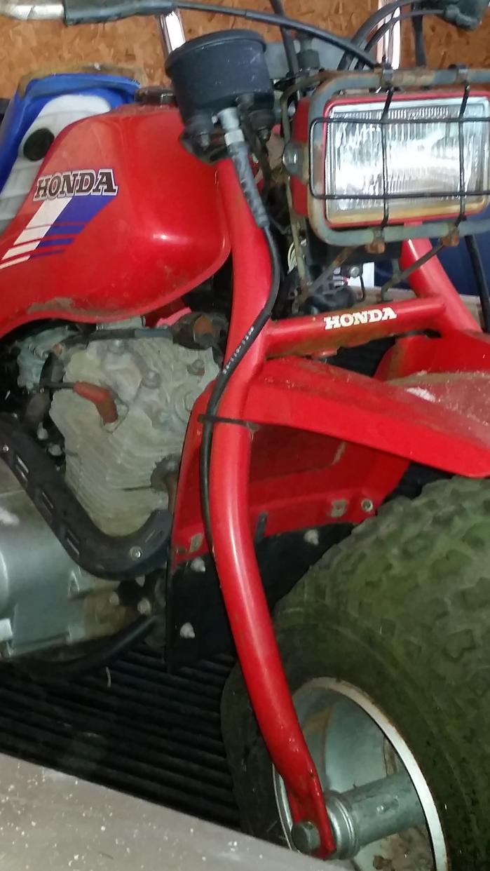

    I have a Honda ATC Speedo on my 86 125M

    The part number you need to mount a speedometer on an 86-87 125M is: 08175-HB600. It comes with the gear box, mounting brackets and cable. I've seen a few pop up on ebay in the past, but nothing in the last couple years.
